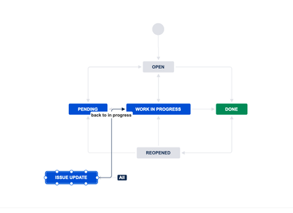

1 - Under project settings > Workflows, configure a workflow status to update the customer with a comment screen, allowing every single workflow status to transition to that one. The status would be called "Issue update"
2 - In the same workflow, configure a transition to move the issues from "Issue update" back to the "In progress" status, where the Agent will keep working in the issue:

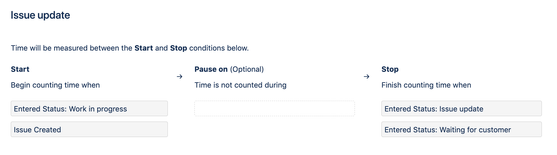

4 - Configure a new SLA metric (Under project settings > SLAs) to stop when the issue is transitioned to "Issue update" or any other status you want, but starting again when it gets to the "In progress" status or when the issue is created:
With the steps applied above, the SLA will properly reset every time you click to update the issue using the status you created. When you must send the customer any comment that is not an update and should not reset the SLA, you can simply click to add a comment.
