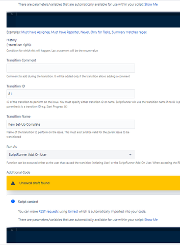

I have a sub-task that is triggered off of a sub-task workflow. Once this sub-task is moved to Done, I would like the post-function to transition the main parent ticket to done.
It looks like this:
New Item Request -> Triggers Item Set-up sub-task -> Triggers Attribution Sub-task - >Triggers Item Audit sub-task
When Item Audit moves to done, I would like the New Item Request parent ticket to move to Done. I tried to use the built-in auto transition parent issue script but it failed (im thinking this is because it was trying to move Attribution to done?)
Please advise!
Jordan

the screenshot you have posted looks like it is from Script Runner. Just for a clarification: are you going the Script Runner route or do you use Jira Automation?

Jordan Artman January 5, 2021
Hi @Bastian Stehmann
Thank you so much for your quick reply! Do you have a code to get the parent? The built in automation looks like this:
