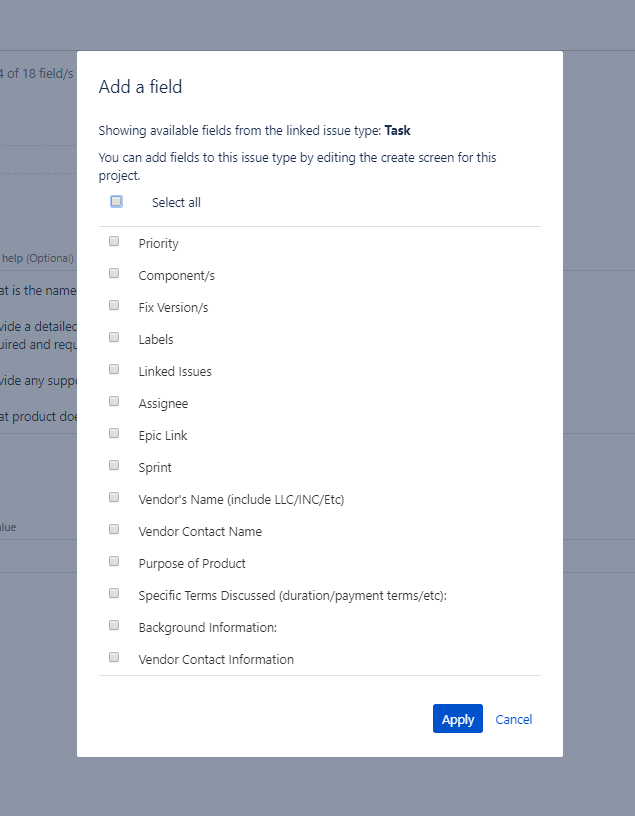

Hello, setting up my service desk, but not able to add due date as a field. Any help or advise would be appreciated. Thanks!

It's just not showing up as even as option which so so strange because I've setup other issue type requests in the same service desk and it was available....

Hi Alison,
  • Go to project settings
  • Go to Screens
  • Go to create screen
  • Ensure that due date is added to the available Fields
