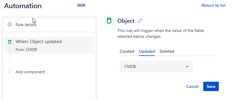

Hi @SheshaChandra (& FYI @Walter Buggenhout )
If you go to the Global Automation rules you can create a trigger for when an Object is created/updated or deleted.

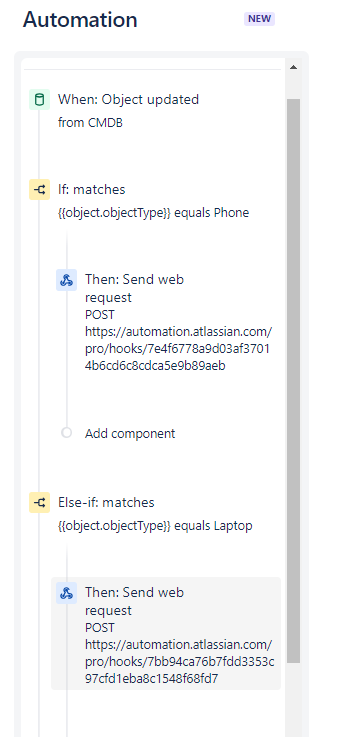

A huge tip here when you are going to use this:
There is a bug, when you have multiple rules that trigger on Asset Object Updated, then some of these will fails sometimes, because they can't get the asset information. If you only have one rule that will never fails.
So my tip: create one rule and make an if/then/else construction to distinct between different object types. For each if/else branch call another automation rule via a webhook trigger.

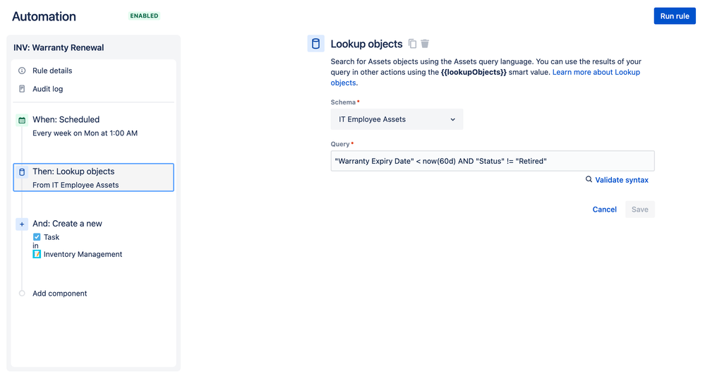

Hi @SheshaChandra,
While automation does not have a separate trigger for when an asset was added or updated, you can set up a scheduled automation rule and use Lookup objects to retrieve a list of objects that match certain criteria and define actions for the result.
Here's an example:
Instead of creating an issue, you can also send an email message with automation. In this example, you can see how smart values can be used to select attributes from the retrieved assets and added to a table:
These are the assets which expired or will expire in next 60 days:
|| Asset Tag || Serial Number || Owner || Status || Warranty Date||
{{#lookupObjects}}
|{{Name}} |{{Serial Number}} |{{Owner.Name}} |{{Status}} | {{Warranty Expiry Date}} |
Hope this helps!
