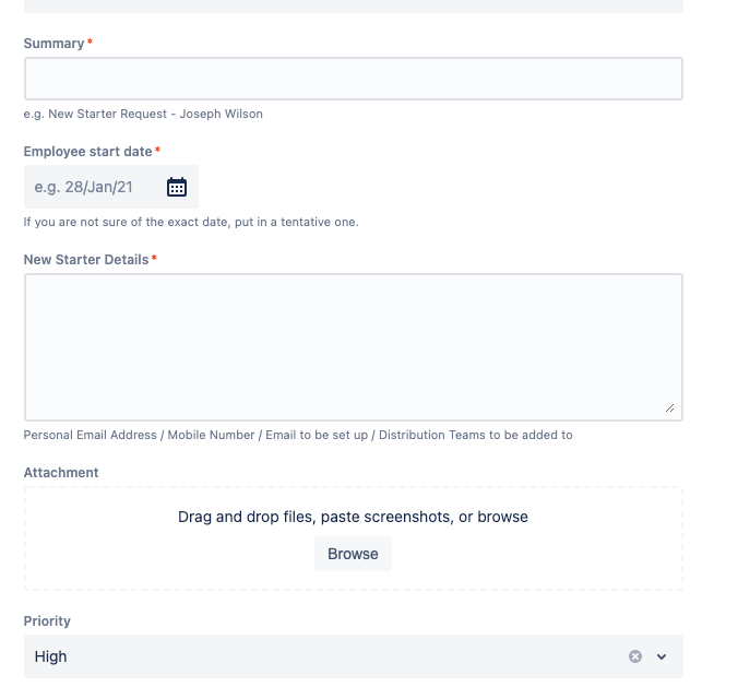

Here is the Request Form and how it shows in the portal.  As below, it has Employee Start date, which we ask customers to fill out.

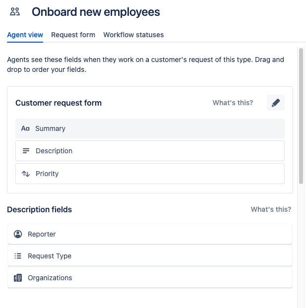

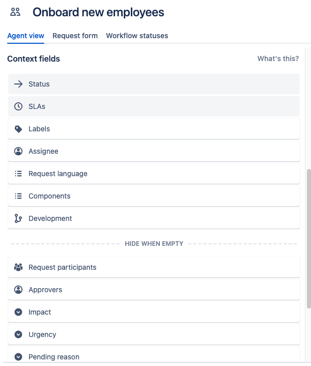

Here is the Agent view.  As you can see, the Employee start date is not present, so when we view the request once it comes through as a Service Request, the employee start date does not show.

With the new issue view you have a small new thing I've noticed.
When you add a field to a Request Type screen (like your start date) it is not auto added on the Agent view screen. To even allow you to select it for that Agent view you need to go to:
Project Settins -> Screens -> choose the correct issue type and add it on the screen there (like you did in the old  issue view).
Once it is on that screen you can also add it on the Agent View (for that Request Type). i even believe it then automatically is added to the "hide when empty" section, but not a 100% on that.
so you'll have to add it once to the issue type screen and then it will become available on the Agent view.
