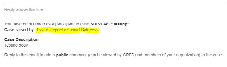

However, when I test this the output just reads "issue.reporter.emailAddress" as plain text. See below as email output.

1) Customer notifications in Service Management - this is the way you are using now and I don't think you are able to get reporter's email (it seems the appropriate variable is not available)
2) Automation rule, which will react to the Request participants field change and send email to the reporter (or something like this). In this case you will be able to use smart values and get reporter's email in the description. But this notification will be handled using different functionality then the others and I would recommend you not to do it.
