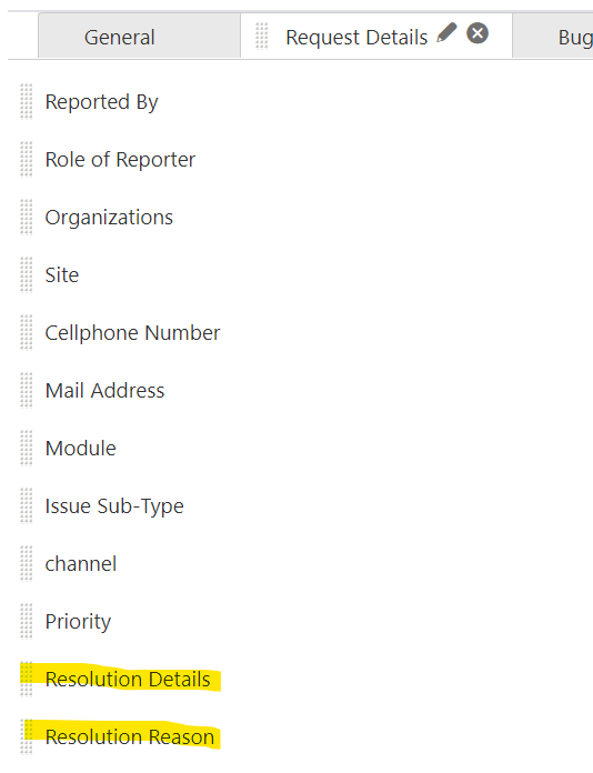

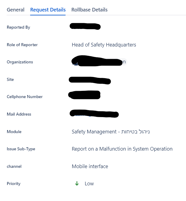

I am trying to set up the view screen for my issue, but I am having some trouble.
There are two fields (image attached) that do not show up on the view screen no matter what I do. I've tried putting them in different tabs, but they do not show up anywhere.
Any ideas why this might be happening?
Thank you

Hey @atarab ,
I can see you added the field to the issue type view which is a great first step.
Now, does your issue also have a request type linked to it? If so you'll also add it to the request type view for the agent. (which you can find when you go to the lower right side and click configure)
Also, what type of fields are they? You are using the new issue view (which is the current default) but not all types are already supported.

Dirk Ronsmans
May 19, 2021
Hmm not sure what's going on here.. I just recreated your situation on my instance and it works fine.
Are you sure you added the field to the edit/view screen? (and not only to the create screen)
