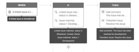

here is something i use. you can make more complex by using different comments based upon the resolution in the JSW issue.
Steven F Behnke
September 7, 2017
Yep Jack is on point –
The "A linked issue is transitioned" is the WHEN even you're looking for. You can use the IF area to set conditions. Typically you'd like to let the customer know that feature was fixed and can be released soon.
