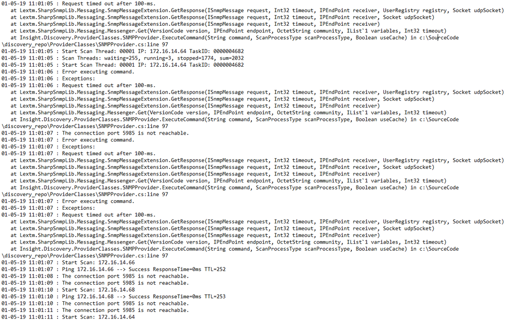

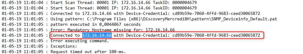

after many tests I see too much basic information when I scan network printers, linux servers and switches using snmpv2, v3 and shell. The credentials are correct though. Here I present part of the logs file showing that I scan a network printer and that the credentials works, discovery is connected. But then for the same printer and when retrieving the information the credentials no longer work and I only get the basic information.
I don't think it's a normal behaviour. How could i change that?
