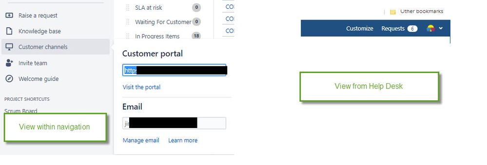

Hi Angélica
Please find below my screenshots.
I'm not seeing any options to "opt in".
Also noting that I'm an overall admin within our instance.

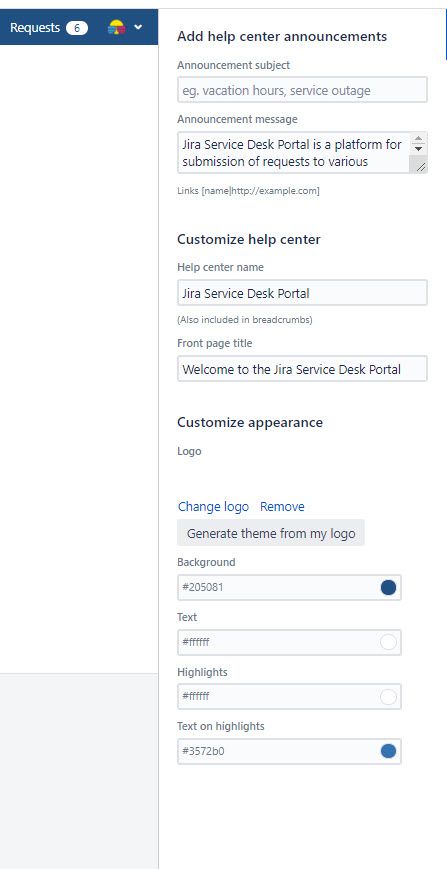

Here is the view I'm seeing from the portal.
I also confirmed that sd.customerportal.customization is NOT in the Dark Features.
