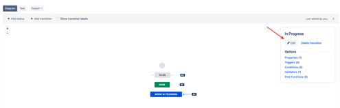

The dialog box displayed when transitioning an issue is basically a screen added to the workflow transition, the same kind of screen configured under your project settings > Screens to View/Edit your issues.
To properly add a screen to your workflow transition, you can follow the steps below:
To create a new screen or edit an existing one, go to settings > Issue > Screens, as explained in the documentation below:
