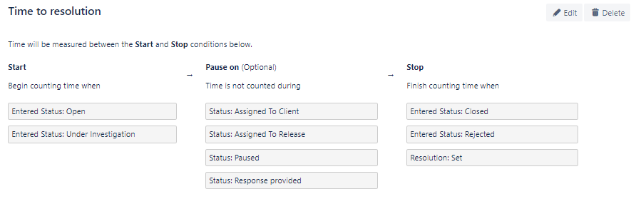

I'm trying to make changes to the Start, Pause on and Stop conditions for a "time to resolution" SLA that has been set up.
However, each time I save the changes and either navigate to an issue or refresh the screen, the changes aren't applied.
I'm trying to move "Status: Assigned to Release" from Pause on to Stop
Steps:
You changed your SLA configuration. Confirm your changes and we'll recalculate your project's SLAs."
I've tried on multiple browsers and get the same behaviour.
Any help would be greatly appreciated

I have tried to change the transitions to trigger the changes as I thought that this might be the case. However, I get the same result and as mentioned above, the changes look like they're unchanged and haven't actually saved.
I'm stumped on what's causing this, as the issue is happening on a number of our older projects. I can try in a next-gen project to see if the same behaviour occurs if this would be helpful?

Nothing happens, it's almost as if the changes made aren't actually saving correctly. I tried going through the relevant transitions on a ticket after making the changes to see if the desired effect has been met, however, the paused doesn't change and when I navigate back to the SLAs page the settings are reverted back to the original (shown in the screenshot above).
