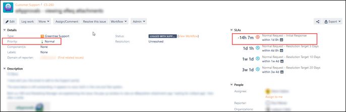

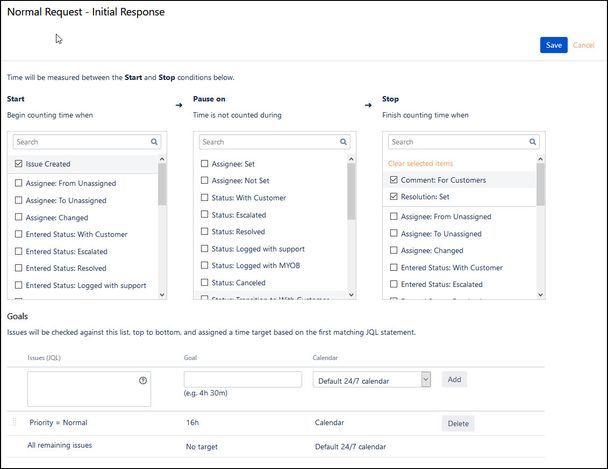

I have set up an SLA for Initial Response.
The only filter on this is that the request is to have a priority of Normal.
Most, close to all, request have this SLA stop when either we add a comment to the customer or a resolution is set.
However, there is the odd one that just has this SLA running even tho a customer comment has been added.
I am not really shore what additional information I can add but please let me know if I have missed something that will help in working out why some SLA's will not stop.

The issue is still in the same project.
I cannot see any conflict with other rules and if there was then all issues that fit this same exact make-up should also be acting the same. And they are not.
We have about 4 comments to the customer and still, the SLA will not stop.
The issue was created by email, same as 100's of other issues. I am going to keep an eye on the issue and see what happens when it is closed out. Hoping it will stop then.
I have tried creating an issue in the same way but it acts as expected.
I have looked at all parts of this issue and compared this to others that are working and cannot see any difference as to why it is not acting the same as others.
