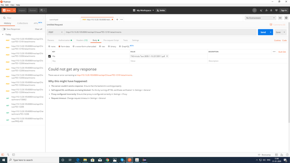

I had set upload  size limit of 10MB and tried adding a file of 41 MB however, instead of providing a response with suitable error code the jira server resets the connection.
For more details please take a look at attached screenshot.
However when the attachment size is less than 10MB it responds correctly.Screenshot (7).png

Sorry to hear about this problem here.  I can see that you're using Postman to try to make a REST API call to Jira Server in order to upload an attachment file, but that this process is not providing a response when the file exceeds Jira's set limit.

So right now, I'm not sure why your REST client is not returning this same kind of error message.  I would like to learn more about your environment so that we can troubleshoot this behavior further.  Could you let me know:
  1. What version of Jira Server this is?
  2. Could we take a look at the headers of your REST call here?  (I don't need to see authorization or sensitive info, just curious if there is some switch there that might be preventing the error response from reaching back to your client in some way)
