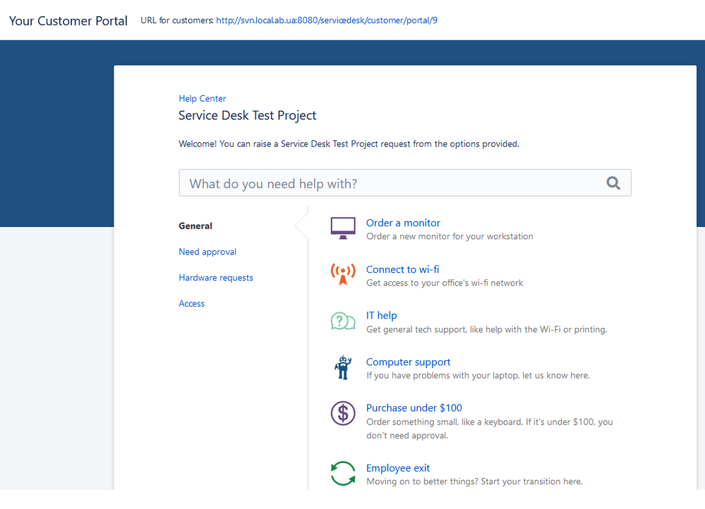

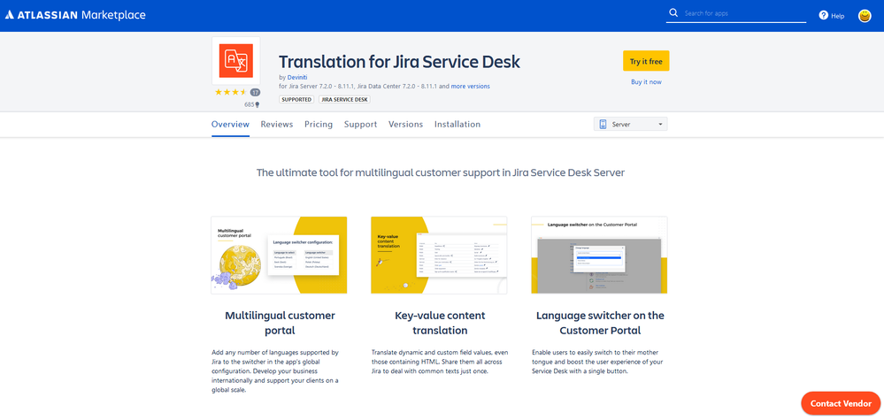

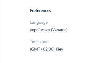

Here's the screenshots:Judging from this the translation is not free of charge:
Now I'm confused. I need my Customers to see the translated version of Customers Portal and to get the translated notifications.
Hello Lena,
I can see that you are using an add-on to translate the customer portal, but the feature "Language support" was added recently to Server.
If you are using the latest version of Service Desk, you should be able to change the language of the portal following the steps of the documentation below:

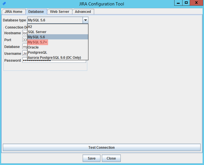

@Angélica LuzIn the documentation the following is said for Jira Configuration Tool:
Navigate to the Database tab and set Database type to MySQL 8.0.
But as you can see there's no such option:There's only MySQL 5.7+ here.
Thank you for sharing the screenshot.
You can select MySQL 5.7+, since the version leaps from 5.7 to 8.0, it means that 5.7+ is any version newer than 5.7.
