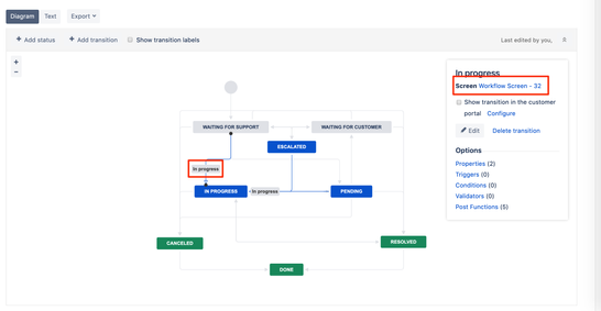

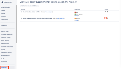

Go to the Project settings (for the affected project) > Workflows > Click on Screenshot 2019-06-12_12-57-43.png for the desired issue type > Click on the transition In progress and on the right side you will see the screen associated with the transition, so click on it.

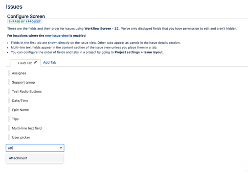

On the next screen, it shows all the fields for that screen, then on Select Field just select the Attachment field.
After that, when you click on In progress it will show the option to add attachments.
