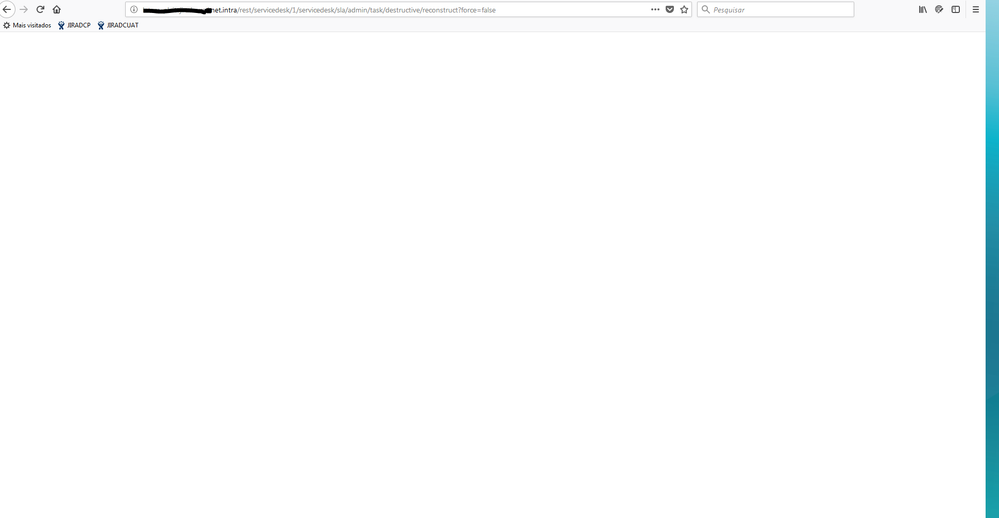

Hello! I'm trying to do this article (https://confluence.atlassian.com/jirakb/missing-sla-data-in-jira-servicedesk-828790603.html), but I received a blank page. I'm using JIRA DATA CENTER
