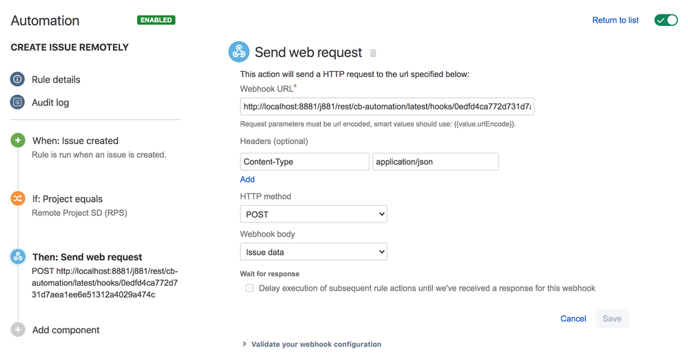

Rule for JIRA Service Desk instance:
This rule will be responsible for sending the webhook onto the JIRA Software instance. Follow the description of each field on "Send web request" action:
  • Webhook URL: This URL is retrieved when creating the rule on JIRA Software instance. Please check on the description under the "Rule for JIRA Software instance" section.
  • Headers (optional): You must insert the same headers as on the screenshot ("Content-Type" and "application/json") in order for this to work correctly.
  • HTTP method: It is POST because you're sending information towards the webhook URL.
  • Webhook body: Select "Issue data" just to make things simpler and so you'll be sending all the issue data.

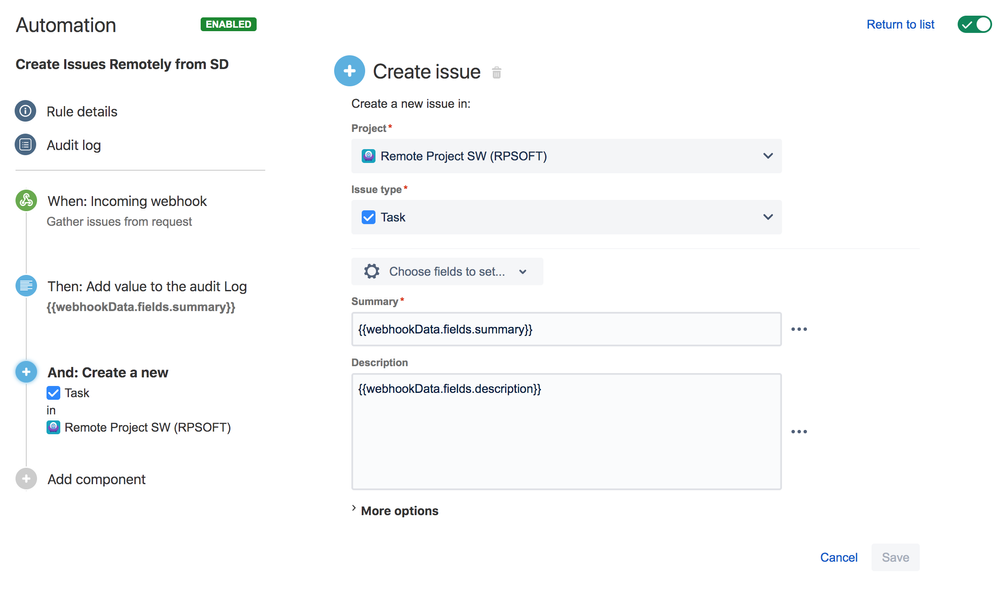

Rule for JIRA Software instance:
Screenshot 1:
Screenshot 2:
This rule will be responsible for receiving the webhook from the JIRA Service Desk instance. Follow the description of each field on both Screenshot 1 and Screenshot 2.
Fields on Screenshot 1:
  • Webhook URL: This is the URL that we'll need to use on the "Webhook URL" field of the previous rule in order to direct the data towards this application. Copy and paste it carefully on the first rule.
  • Execute this automation rule with:: Select "Issues provided by webhook HTTP POST body" as we are sending the issues directly through the POST body;
Fields on Screenshot 2:
  • Project: Here you'll need to select the project under your JIRA Software instance that must receive all the issues that will be created from the JIRA Service Desk issues;
  • Issue Type: Here you must select the issue type that the issue will be created on. In case you need to create issues from different issue types, it is possible to add some conditions with "If block condition" and make separate "Create Issue" actions for each of the issue types.
  • Summary and Description: Here we must use a "Smart value" that works as a way of retrieving data that came from the "Webhook data". The logic for this specific scenario is that the "webhookData" object contains the "fields" object in which all the fields are inside. So, for the summary I've used {{webhookData.fields.summary}} and for the description I've used {{webhookData.fields.description}}. You'll need to add all the fields you want under the "Choose fields to set" option and then use the same logic to get the field values from the webhookData object.
