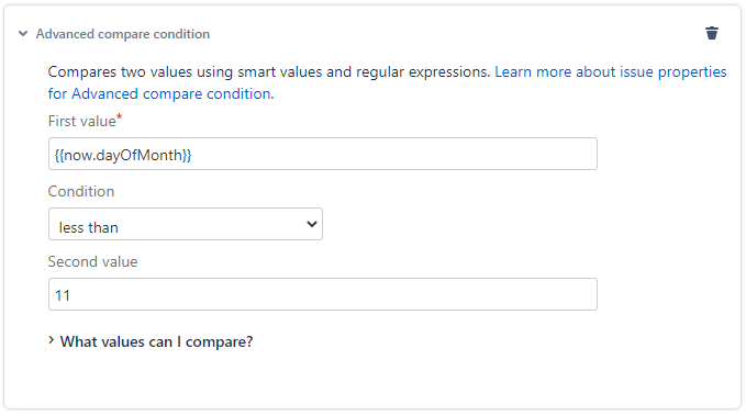

{{now.dayOfMonth}}returns the number, e.g. on the 25th February returns 25, we can compare it with any number:
{{now.dayOfMonth}} is less than 11means the first situation - from 1st to 10th day of the month.

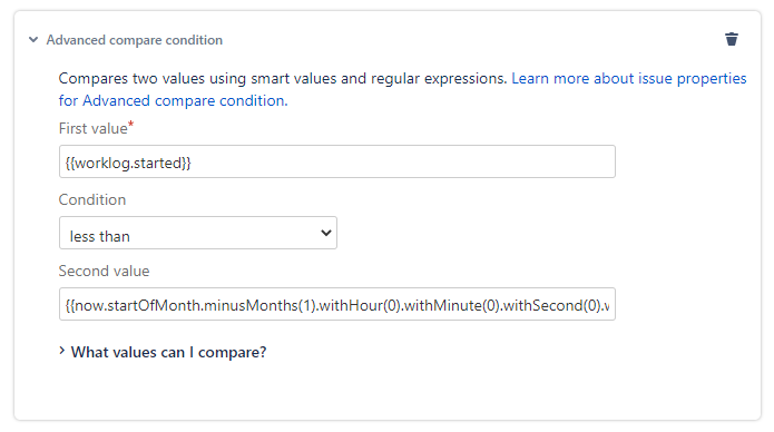

This can also be done using the Advanced compare condition.
I can simply compare two dates, which one is earlier.

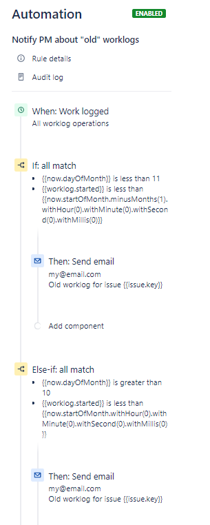

When: Work logged (all worklog operations)
If: all match
{{now.dayOfMonth}} is less than 11{{worklog.started}} is less than {{now.startOfMonth.minusMonths(1).withHour(0).withMinute(0).withSecond(0).withMillis(0)}}-> Then: Send email
Else-If: all match
{{now.dayOfMonth}} is greater than 10{{worklog.started}} is less than {{now.startOfMonth..withHour(0).withMinute(0).withSecond(0).withMillis(0)}}-> Then: Send email

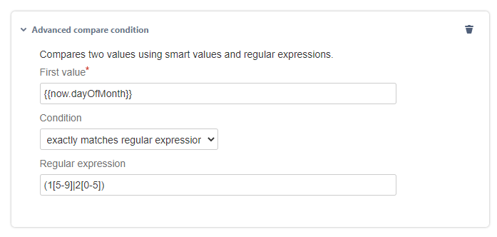

In the Advanced compare condition you can always use regular expressions like:
(1[5-9]|2[0-5])
This means from 15th to 25th day of the month
