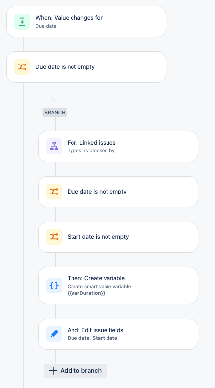

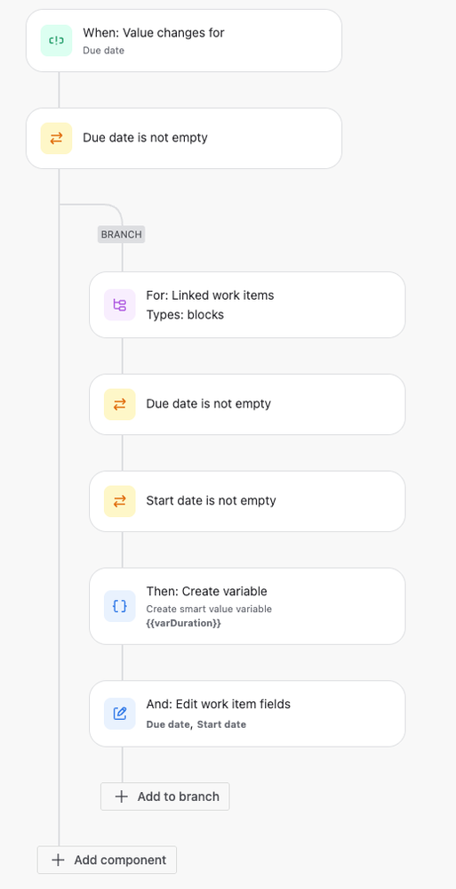

Here is a summary of the rule:

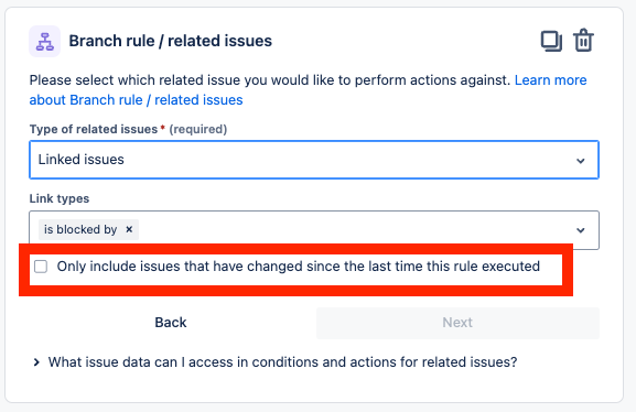

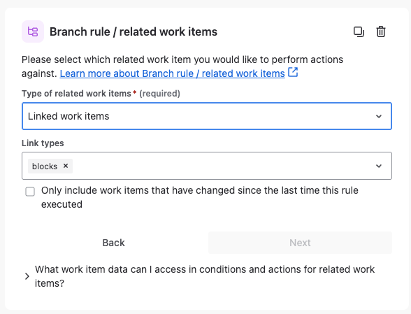

Note that in the Branch component you will want to uncheck this box:
The rule components that need more explanation are the last two; Create Variable and Edit Issue Fields

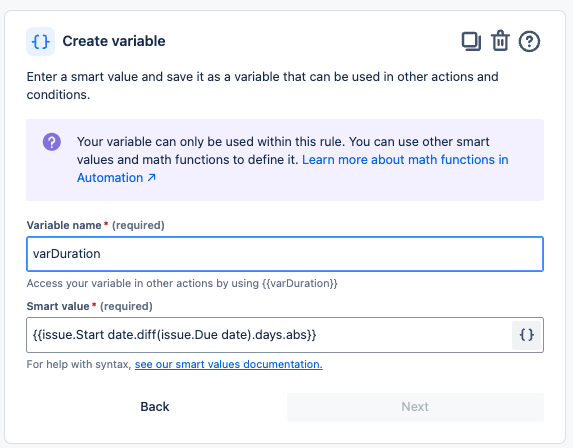

To get the original duration of the dependent task we get the difference in days between the original Start date and original Due date using smart value function diff() described in Automation smart values - date and time . We store this in a variable for use in the next step of the rule - Create Variable.
Note: You can alternately get the duration in business days by using businessDays instead of days.

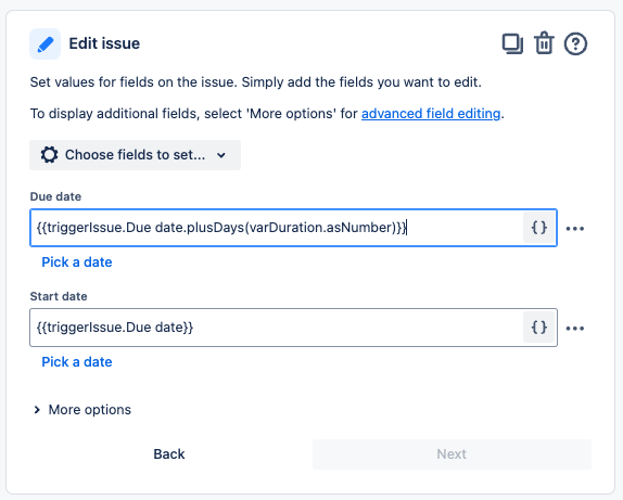

In the Edit Issue action we use smart values to set the Start date and Due date to new values for the dependent task.
The dependent task’s new Due date is its new Start date plus the number of days calculated as its duration. We stored the duration in a variable we created earlier. We can use the plusDays() function to add that variable value to the new Start date to get the new Due date.
We are changing the Start date in this same Edit Issue action. To avoid any collisions in changing data we will reference the trigger issue’s Due date in setting both the new Start date and Due date for this dependent task.
Start date: {{triggerIssue.Due date}}
Due date: {{triggerIssue.Due date.plusDays(varDuration.asNumber)}}
Variables are stored as strings, so we use asNumber to convert that to a number for this calculation.
