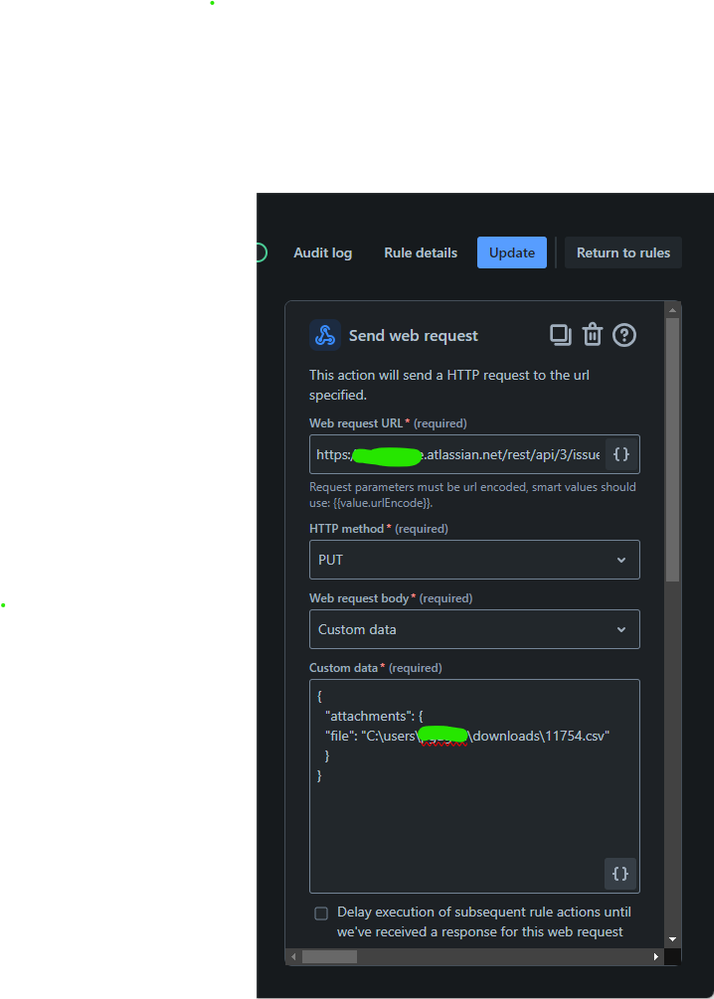

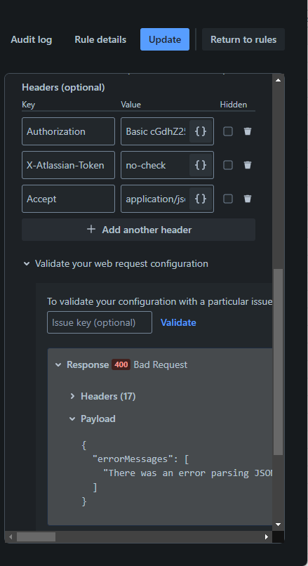

I'm able to confirm (200 Response) with my credentials, however when I extend the request to perform an action, I'm getting a 400 Response.   I've read some links from earlier posts, but I'm still struggling to get this to work.  This wanna-be programmer would be greatly appreciate any help!!  :0)
My web request looks like this:

Hi @Peter Gagne ,
Good to hear your credentials are working, that's a great start.
You have chosen a pretty complicated request with adding attachments, so I will be adding some reading material and as you are a (wanna-be in your words :) ) programmer, I will try to guide but let you figure some things out on your own.
  • You can find all public APIs for Jira documented in their Jira Cloud platform REST API overview, and lucky for you it has a posssibility for adding attachments here
    • Check the HTTP method
    • Check the format of the body you have to send
  • You can't just pick an attachment from your disk on your PC and upload it in a rule for a few reasons:
    • If you run the API from automation, how will the rule get access to you local C drive?
    • Read up on multipart/form-data in here to check how you should send attachments
Please let us know how it works!
- Tessa
Peter Gagne October 21, 2024
Thank you @Tessa Tuteleers !!   I was stuck on keeping it so simple, it prevented me from thinking outside the box.  I now realize the approach I need to take and appreciate your setting me on the right path.
