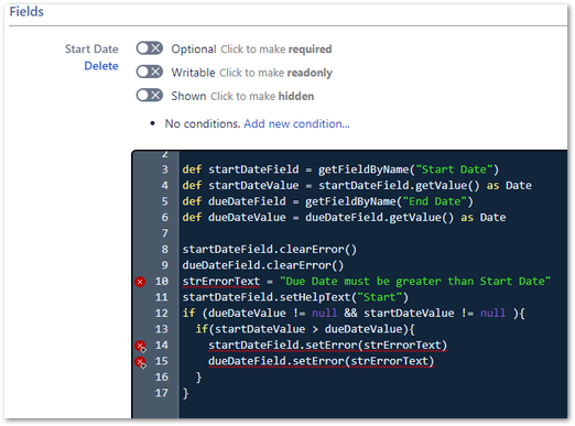

Try something like this (untested)
import com.onresolve.jira.groovy.user.FieldBehaviours
@BaseScript FieldBehaviours fieldBehaviours
def startDateField = getFieldByName("Anticipated Start Date and Time")
def startDateValue = startDateField.getValue() as Date
def dueDateField = getFieldByName("Anticipated End Date and Time")
def dueDateValue = dueDateField.getValue() as Date
startDateField.clearError()
dueDateField.clearError()
strErrorText = "Due Date must be greater than Start Date"
if (dueDateValue != null && startDateValue != null ){
if(startDateValue > dueDateValue){
startDateField.setError(strErrorText)
dueDateField.setError(strErrorText)

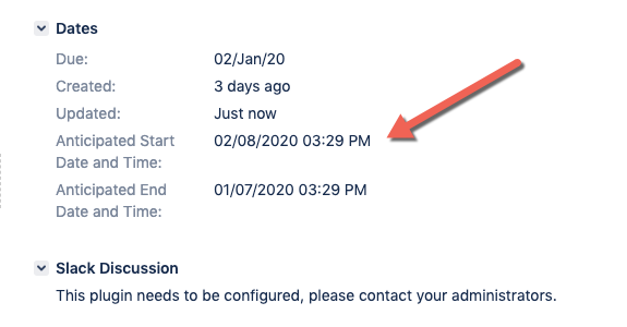

Kay January 21, 2020 edited
@PD Sheehan
Thank you for your answer. However, after creating the ticket, I still can directly edit the start date to be bigger than the end date. It doesn't throw me any error under the two fields below. When clicking on "Anticipated End Date and Time" below, it will bring me to edit the ticket page. I can't edit the date directly like "Anticipated Start Date and Time". I think this happens because I choose "Anticipated End Date and Time" as the field in Behavior. Are there any ways that we can enable the in-line edit for both fields after creating the ticket and the error will be thrown under the two fields below rather than in the edit ticket page?

Update:
I can do the inline edit for "Anticipated End Date and Time" now by disabling "Behavior inline edit issue assets" in Jira Manage Add-ons. However, I still can't get the error when selecting the start date greater than the end date. I would like to see the error under "Anticipated Start Date and Time" or "Anticipated End Date and Time" when I do the inline edit on either one, not on the edit ticket page. Thank you.

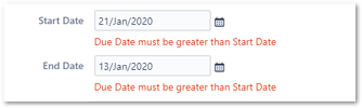

I have implemented the suggested code in my test environment. And it's working as described:
2020-01-21 10_50_10-Behaviours - JIRA QAD Inc. - Corporate Issue Tracker - https___projects-gcp.qad..png 2020-01-21 10_49_03-Edit Issue _ JSP-4362 - JIRA QAD Inc. - Corporate Issue Tracker - https___projec.png
