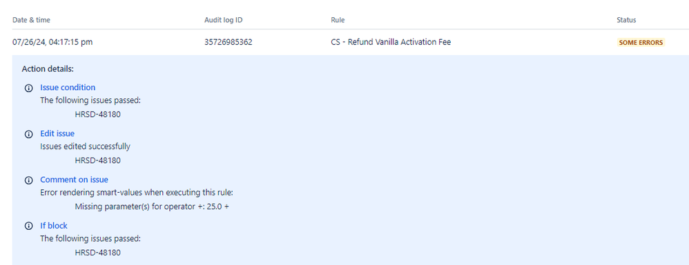

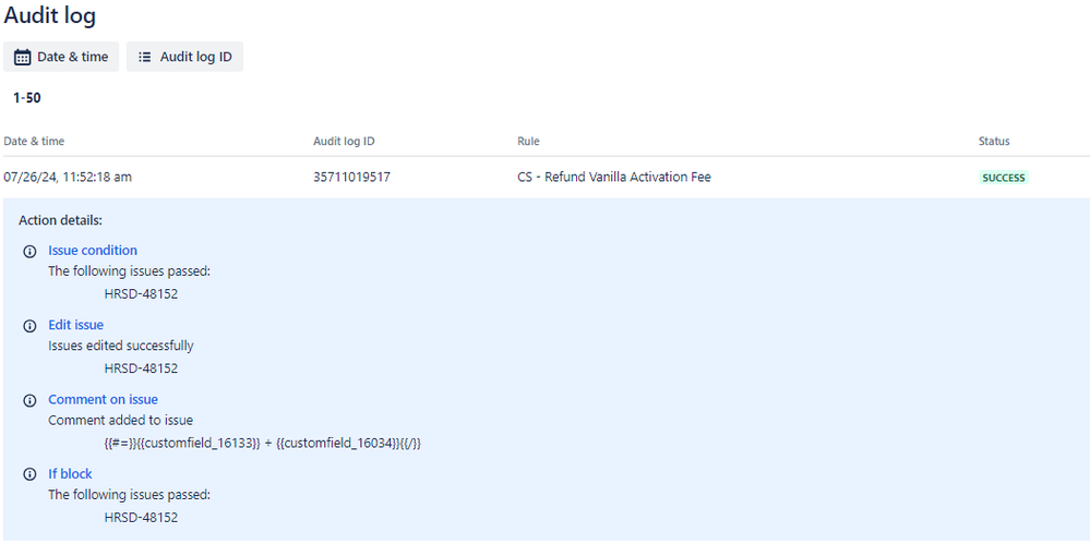

here is the audit log of the automation, it shows as successful and that the equation is commented as written.

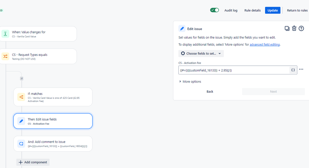

Hi @Tim Kopperud

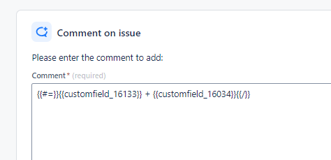

no problem, here is the code for commenting an outcome.

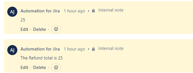

The bottom comment happens first this displays the 1st custom field in this case the remaining balance that is inputted in the form. the top comment is supposed to show the 1st custom field + the 2nd custom field which in this case is fee and then comment the result. As you can see it is not adding the field. this field is being set in a radial field

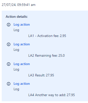

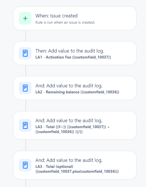

@Ethan Bhardwaj, since it seems you are using this rule for testing, I might recommend another approach for error investigation on smartvalues:
I have created an example rule for trying to reproduce the error:
Mapping of CFs are:
16034 => 10215 Remaining fee
16133 => 10216 Activation fee
This created the following in the log entry when I executed it manually (no errors):
This way we can see where the log actions (LAx) first hit an error. E.g. in your case you can see if its about fetching the value (in LA2) or if it is the formula (in LA3) etc.
Can you try something like this, and post the result?
TimK

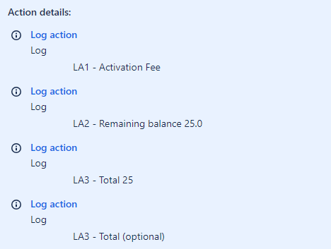

Hi @Tim Kopperud ,
Thank you for your response,
As you can see from the tests, the Activation fee is not being set correctly.

Hi @Ethan Bhardwaj, sorry for my short reply yesterday, I was "PC offline", hence was not able to test accordingly, and replied from mobile. After testing it seems it works without using ".value" syntax.
I do agree with @Bill Sheboy and @Dick that refetching the issue is important when you, within the rule, edit a field value and attempt to use that newly set value later in the same rule.
But when you post this image
I understand you have created a test rule as recommended earlier which is triggered manually and is as simple as possible with no edit or filter, hence you haven't actually edited the issue within the rule when doing this test. Is this correct?
The red line above is where we expect to find a number.
The next image you attached doesn't show this test rule as I cannot see any "Log actions" in it.
Can you provide an image of the test rule where ypu are setting the log actions? Most important to include is the Log action for LA1 (red line above).
TimK
Good Morning @Tim Kopperud
Thanks for your continued help is appreciated.
Attached is the test automation yet sent to me, I switched it to when a form is created. Both values of the custom fields are defined when the form is filled out, as both the remaining balance and fee need to be entered here. So in this case, as you can see in the XML code the "Activation fee" field is being defined as I have tested with other numbers and the XML reflects this change. I hope this all makes sense.

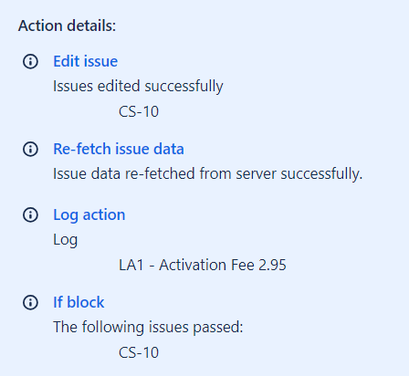

Hi @Ethan Bhardwaj, I don't have the solution yet, but we might get there soon.

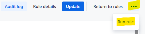

Can you, in the test rule (your image above) switch the rule trigger (green step) and replace it with Scheduled trigger? You can replace it by simply delete the existing trigger and add a new one.
In that scheduled trigger:
See my previous image (with all those yellow markings) as an example hwr to configure the scheduled trigger.
Execute the rule manually.

This is where the issue is being applied in a separate automation the fee is being applied like this, I have added a log action to this automation to check to see if the problem lies here but as you can see from the attached audit log it is being updated correctly, for some reason, this is not being updated when the other automation is trying to add and comment them to the raised form.

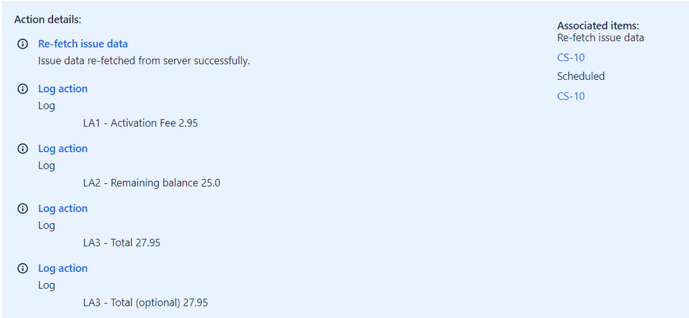

I updated the test automation with audit log reporting and it seemed to work here.
As you can see this has worked when re-fetching the details from the the CS-10 form reference.
Maybe it is what @Bill Sheboy is saying and the trigger is firing too quickly causing it not to capture any data. I have tried editing the automation that does the equation and have the re-fetch data straight after the trigger is activated but I get the same result as previous.

Hi @Dick
we have added the issue. to the custom field ID and we have reviewed the Audit log and have received back the following error "Missing parameter(s) for operator +: 25.0 +"
In this instance, it does not add the "Activation fee" Custom field even though it is being set, as shown in the XML above.
The re-fetch that @Bill Sheboy suggested is essential here. One of your fields is not carrying the value.
Looking at the above log, it's the commenting of the issue (last step) where the codes throws an error.
