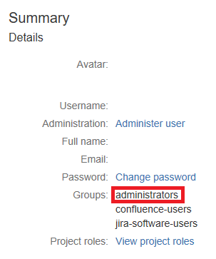

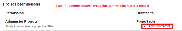

JT April 21, 2017
NOTE:  Some field data has been removed from the images below.
Since assigned to the "administrators" group, how is this possible below ?
Cap1.PNGI am assigned to the administrators group.  The documentation uses the terminology JIRA System Administrators, JIRA Administrators, Administrator, Project Administrator, and Board Administrator - but all in different parts of the documentation.  The Settings uses Administrator - which I assume applies to any "Administrator."
So to which group does an "administrators" assigned Group member belong ?

Hi HJLBX - Roles and groups are different things.
Your user is in the 'administrators' group, but the 'Delete issues' permission is given to the 'Administrators' role. If the 'administrators' group does not hold the 'Adminsitrators' role in the project you are interested in, then people in that group won't be able to delete issues.

What this shows is that people in the 'jira-admistrators' group have the 'Administrators' role for this particular project, but people in the 'adminstrators' group do not. Something like this probably explains why your user can't delete issues.
Putting them in the 'jira-adminstrators' group will probably solve the problem for you.

If we assign the "administrators" Group to the Administrator's Role, will this allow the "administrator" to delete?
Yes - assuming your project uses the default permission scheme, which has the 'Delete Issues' permission granted to the 'Administrators' role.
To change existing projects, you'll need to do this using 'Users and Roles' from within the project settings.
If you want this to happen in all new projects created in future, you can use JIRA Administration > System > Project Roles > Manage Default Members.
Another opton is to simply grant the 'Delete' issues permission directly to the 'administrators' group, then they don't have to hold any particaular project role to be able to delete issues.

  • There is no 'jira-developers' group
  • The 'administrators' group is not a member of the 'Administrators' project role by default
  • However, there is a 'jira-administrators' group which is a member of the 'Administrators' project role.
