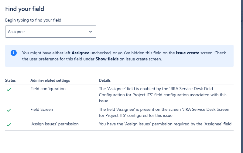

Amanda Gray November 20, 2024
Hi @Jehan Bhathena
yes i did but it just came up with this, I also dont have a lot of custom fields.

Jehan Bhathena
November 21, 2024
Hi @Amanda Gray
Thanks for the image, as the Blue Ribbon points out, can you check the "Show Fields" option to verify if the Assignee field is not hidden on the create issue screen.

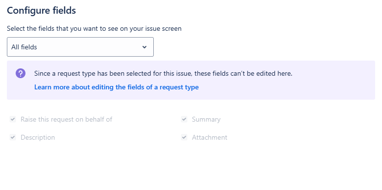

Amanda Gray November 24, 2024 edited
Configure Fields.png It doesnt let me drop down to anything @Jehan Bhathena
Jehan Bhathena
November 29, 2024
Hi @Amanda Gray
From your previous message it seems that you're using a JSM Project. For that you can follow these steps:
  • Go to the project where the assignee is not shown on the create screen
  • Project Settings -> Request Management -> Request Type -> select the category under which you're creating the issue
  • Open the Request type where assignee needs to be added -> Issue View -> Search for assignee in the available fields and add
If in case these steps don't work too, I've tagged the Atlassian team on this thread and they should get back to this question in a few days.
