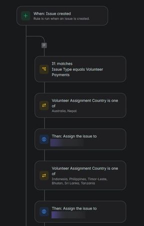

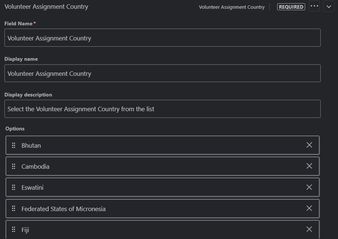

×I have to create an Automation Rule to assign the request to specific user based on the Country selected from the dropdown custom field.
I am using the logical operator of 'one of' and then selecting the Countries from the available value to build automation.
I created the Automation using IF condition. When I created a Test request and selected a specific Country, the request stays un assigned.
screenshot of the field from request type
screenshot of rule (partial to give an idea)

Hi @Mitesh Shah
Without first seeing the rule's audit log details, I see two things to correct in your rule:
(1) The Issue Created trigger can start a rule so quickly that some data may not be ready for the rule to use. To fix this, please add the Re-fetch Issue action immediately after the trigger. This will slow the rule slightly and reload the data before proceeding.
(2) Your rule is using an if / else condition block but has all the conditions bundled in one area. Instead you want separate if and else / if sections, as shown in the documentation.
With this changes, your rule would look like this. Please adjust based on your actual conditions required.
A simpler way to do this may be using a Lookup Table. That would allow mapping the countries to the appropriate assignee. If you want to try that, please see the examples in the documentation:
https://support.atlassian.com/cloud-automation/docs/jira-automation-actions/#Create-lookup-table
Bill
