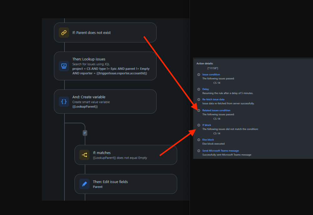

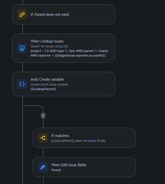

I am trying to create an automation rule that automatically links the newly created ticket to an epic for a new JSM project. In this project, each epic will represent a different customer project that my team is working on. My current rule is below. I am trying to use the reporter account ID to match the new issue to another that the user has made before and then copy that parent link to the new ticket. Do you guys have suggestions to make this method work or another method that would work better?

I am looking for issues created by the same person in the same "CS" project. The lookup issues is working as expected. The main part I am struggling with is being able to take the same parent and link it to the newly created ticket.

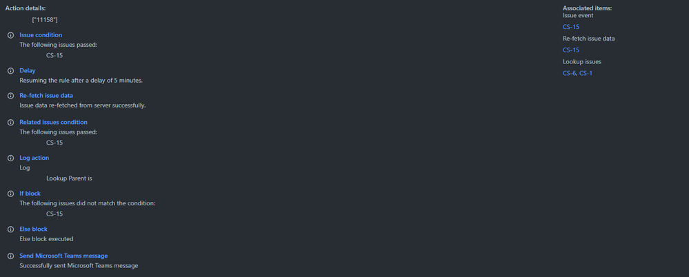

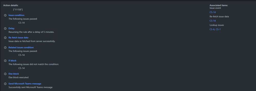

Lower in the rule, I have an else block which is performing as it should. But the audit log is stating that the newly created ticket does not match the first if statement which is supposed to do the automatic linking.

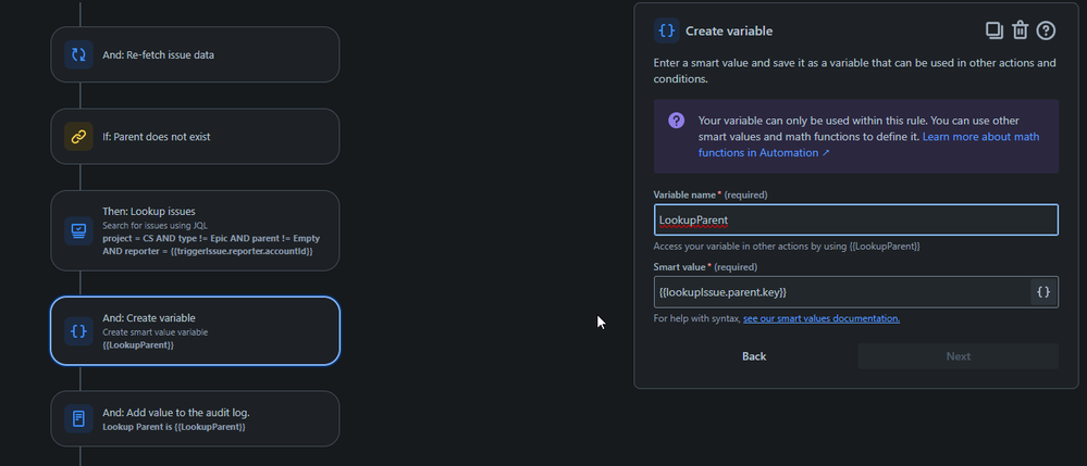

Can you show us the details of the Create Variable action?
Can you add a Log action after the Create Variable action, to print to the log field the value of {{LookupParent}}? Then try running the rule again and share the audit log with us.
Hi Trudy,
Here are the details as requested. Thanks for the help! In doing the log action, I found out that the {{LookupParent}} is not populating which is a good step!
Audit Log:
Variable Details:

Hello Christopher,
The next things to check would be the value you are trying to assign to the variable, and how many issues are being returned by the Lookup Issues action.
The smart value {{lookupIssues.size}} will tell you how many issues are in the result set.
Your variable may not be getting set correctly because either your Lookup Issues action is not finding any issue, or because the smart value you are using in the Create Variable action is wrong, or both. In this case I can confirm that the smart value you are using in the Create Variable action is wrong.

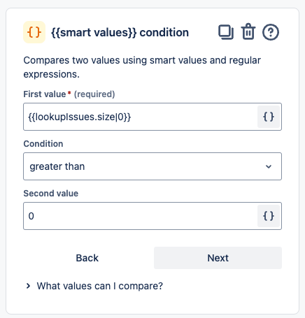

I do recommend that you add a Ccondition after the Lookup Issues action to confirm that at least one issue is found. You can do that thusly:
That will confirm that there is at least one issue returned by the Lookup Issues action.

Did you notice the Create Variable action was using an incorrect smart value for the lookup issues result? It was singular and not the plural {{lookupIssues}}
