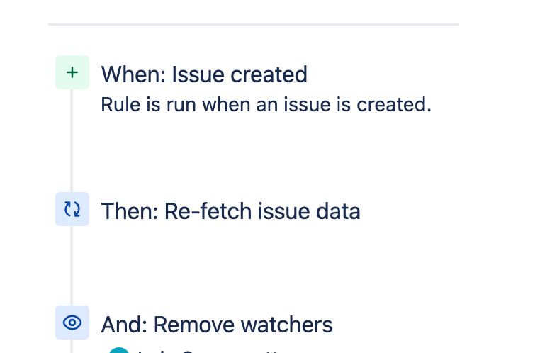

Elif Alverson
January 23, 2023
@Bill Sheboy , thank you so much for your response. I am testing the second way you suggested. Could you please assist me with adding multiple actions to this automation? I would like to remove a specific watcher ;
1- When the issue is created
2-When the issue is transitioned
3-When the issue is updated
4-When the issue is commented
Is it possible to have one automation , or does this require 4 automations? Thank you so much for your help and understanding.

Bill Sheboy
January 25, 2023
With the Jira Cloud version of automation, I do not believe it is possible yet to select those different triggers together.
One work-around is to have separate rules for each of the relevant triggering conditions.

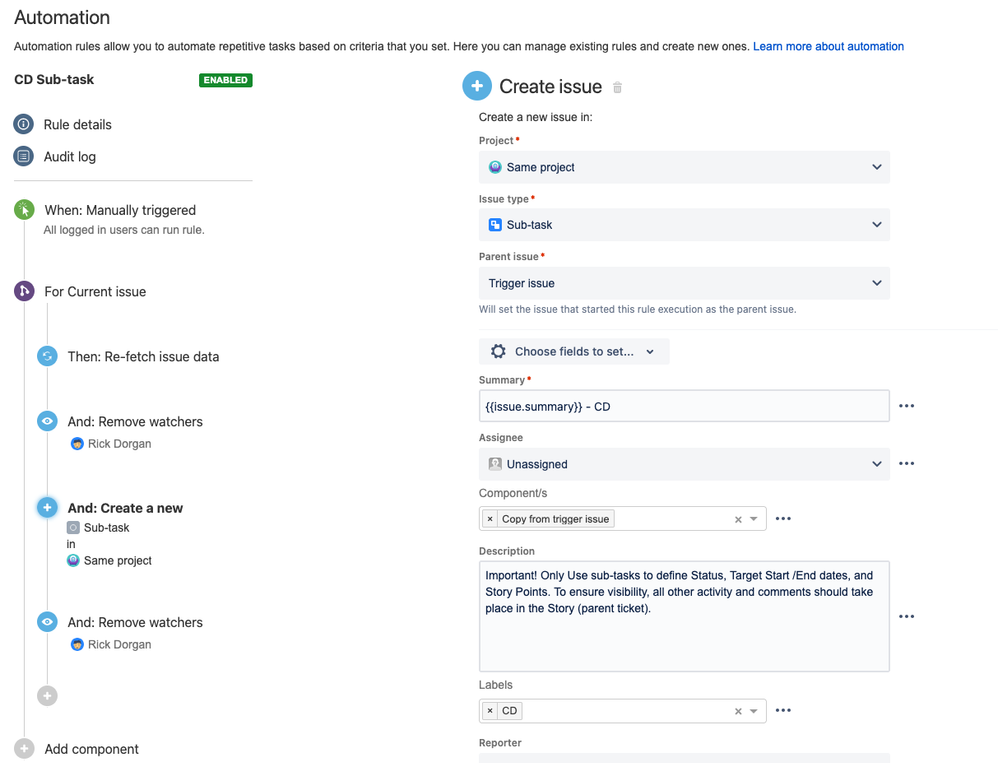

@Bill Sheboy- I created an automation rule (Jira Server) and can't seem to remove myself as a watcher. The rule is manually triggered, and creates a sub-task. Screenshot attached. I can remove myself from the story using the additional action...but not the sub-task. Any thoughts? Screenshot 2025-04-08 at 3.21.35 PM.png
Bill Sheboy
April 8, 2025
Hi @Rick Dorgan
First thing: this is a very old thread, and I recommend creating a new question, perhaps including a link back to this one.  That will ensure the maximum number of people see it to offer suggestions.  Thanks!
As for your specific question, this is about issue-scope in the rule as that determines what a rule action will act upon.  The fix for your scenario is to branch to the most-recently-created issue when you want to change it.  To do this, remove the branch for current issue (as well as the re-fetch action as it is not needed).
For example:
  • trigger: manual
  • action: remove watcher (from the trigger issue)
  • action: create the subtask
  • branch: to most recently created issue
    • action: remove watcher (now from the subtask)
In my experience, the branch for current issue is typically only needed for one case: to use a single condition and keep the rule processing the remaining steps without using if / else.
For example (and unrelated to your actual question :^)
  • trigger: some trigger...
  • branch: for current issue
    • condition: check something
    • action: do something
    • action: re-fetch issue (only include this when the action above was an edit of the trigger issue)
    • condition: check something else
    • action: do something else
Bill
Rick Dorgan April 9, 2025
Thanks, Bill. Your example worked great, and simplified the steps in my rule. Appreciate the quick reply. Next time I'll be sure to open a new post.
