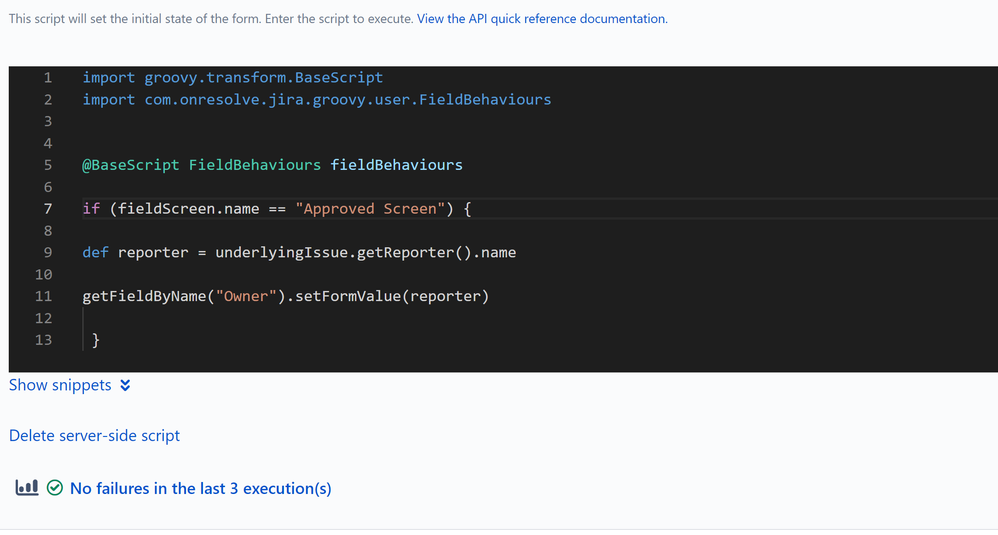

Thank you @Hyrum Steffensen _Appfire_ for your quick response.
Did I miss anything here? I'm receiving an error in the script. I added as server script in the behavior.

Try using "underlyingIssue" instead of "issue". I tested the following and it works.
import org.apache.log4j.Logger
def log = Logger.getLogger("com.onresolve.scriptrunner.runner.ScriptRunnerImpl")
log.error("fieldScreen.name: " + fieldScreen.name)
// if (fieldScreen.name == "Approved Screen") {
def reporter = underlyingIssue.getReporter().name
log.error("Reporter name: " + reporter)
getFieldByName("userPickerSingle").setFormValue(reporter)
I also added some logging for debugging. These will show up in the Jira system logs. Remember to remove the lines with "log.error" before deploying the code to a production environment. The "error" logging level will spam your system and consume lots of system resources.

Thank you @Hyrum Steffensen _Appfire_ .
It's working expected.
