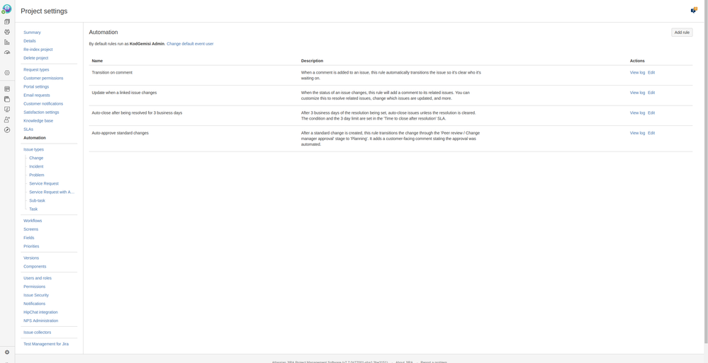

Elifcan Cakmak
October 22, 2018
You can use the automation feature of Service Desk, if it's a service desk project as you tagged.
