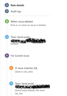

Here are the different steps of my workflow :
First step : Issue Deleted
2nd step : Email => OK
3rd step : If => KO
Here I got the error :
Please note that I got the same issue by moving the "If step" before sending the email
It seems that the key is available in the "email step" but not in the "check label step"....

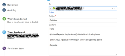

(*) 1st email, I got this result
Objet : Deletion
Hello ,
XXXX-11233 // TEST - 2 // obj_test

Two thing - Your example above has text in the email create that does not appear in the sample you provided, so I am assuming you modified it before the test (or afterward).
