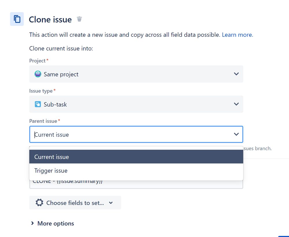

On your Clone Issue action, you need to explicitly set the issue type to sub-task. This will present an option for where you can set the parent.
In the end, it should look something like this:
This should do the trick
Silly question, where do I add this section
Sorry - Edited my previous post to correct my miss
I tried this before, but for some reason it only gives me 2 options
parent issue = current issue or parent issue = trigger issue
You can start typing {{varNewParent}} and it will let you set it as a smart value.

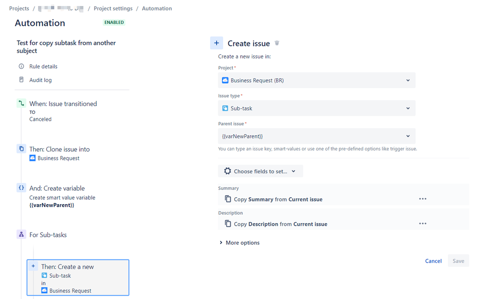

So this is a cross-project automation? If so, you may need to perform an Issue Create for the sub-task instead of cloning and then manually set all of the fields that you want copied over.
Hi @Mark Segall
Thanks for your answer, creating valuables works for the same project

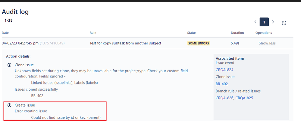

I am also facing with the same issue for cross-proejct automation.
Would you mind elaborating more detail on the resolution you mentioned or any suggested adjustment on auto setting (refer to Pic2)?
Stuck in this stage now.
Hmm.... This looks ok on paper. I'd take the following troubleshooting steps:
{{createdIssue}}
{{varNewParent}}
@Angela Chen When creating the variable, I used {{issue.createdIssue}} as the smart value and was able to successfully clone cross-project with subtasks under the parent.
