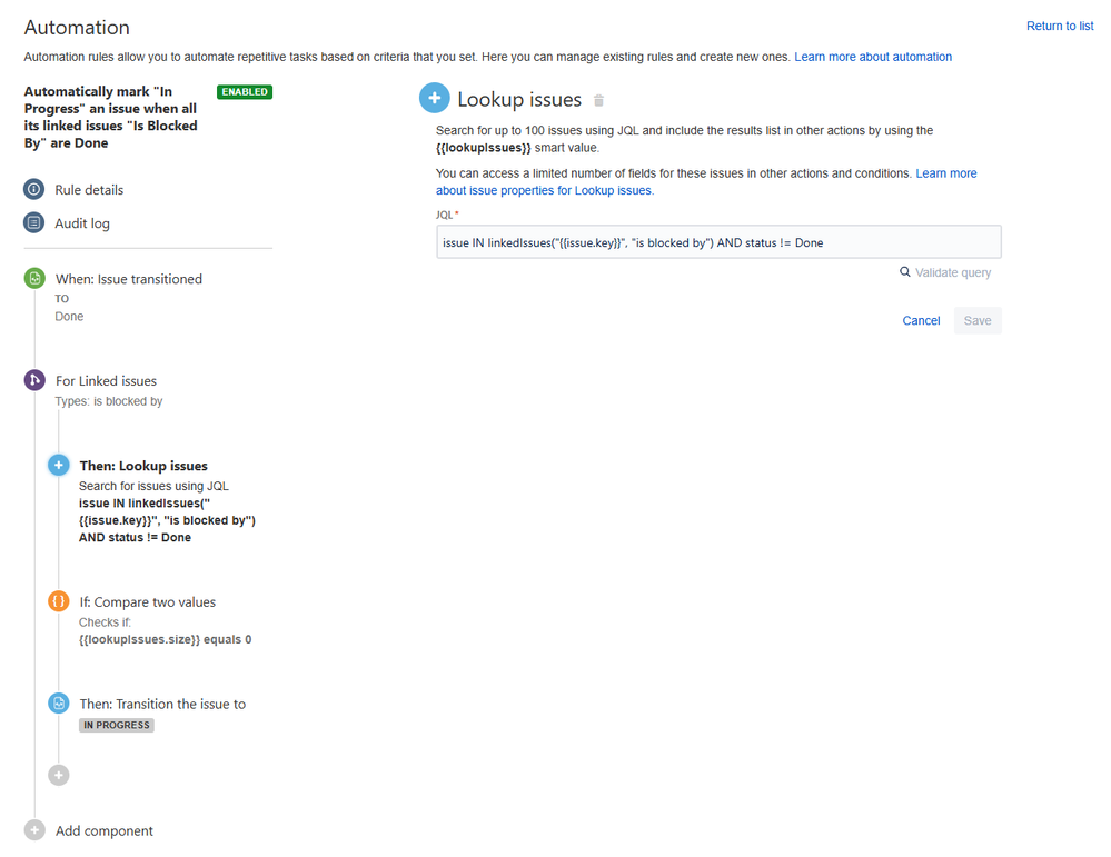

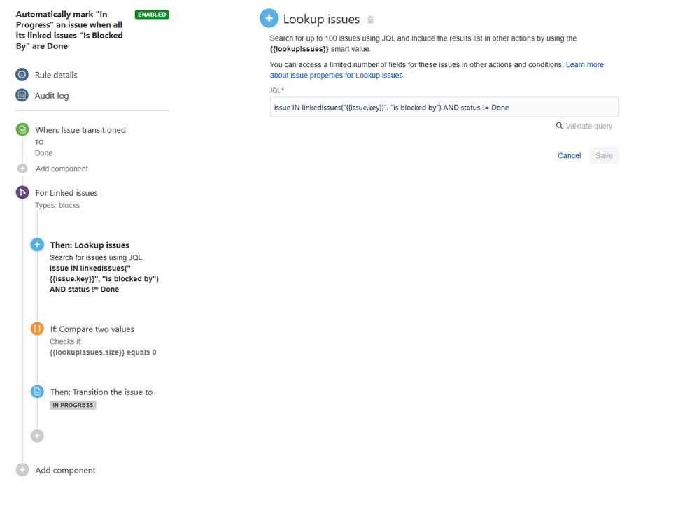

Hi Team,
Automatically move the Defect Issue Type ticket to "In Progress" status when all its linked issues "Is Blocked By" are Done from tickets that are related to any other issue type. I used the automation rule below, but the ticket defect's status is not changing, even though all the linked tickets are done. Did I miss anything in this automation rule?

Hi @Lakshmi CH
What is the relationship between the Defect Issue you want to update and the trigger issue for the rule?  Knowing that will help clarify how to structure your rule.
As written, this is what your rule is doing:
GIVEN any trigger issue linked to other issues as "is blocked by"
WHEN the trigger issue transitions to Done
THEN for each of those linked issues
  WHEN the issue has no linked issues as "is blocked by" which are not "Done"
THEN transition that issue to "In Progress"
Is that what you wanted?

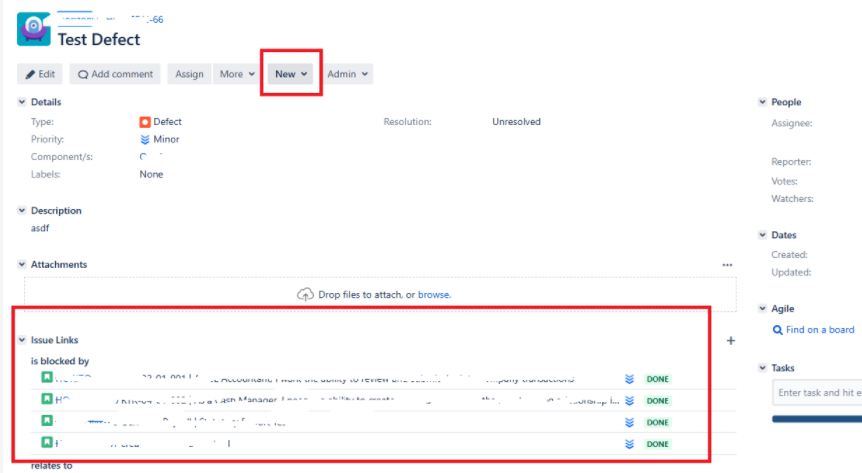

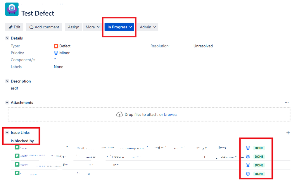

Hi @Bill Sheboy , Thank you for your response.
If you see the belwo screenshot, if all linked tickets with "is Blocked By" are in the "Done" status, the main ticket, should move to In Progress status.

It seems your scenario is this:
GIVEN a Defect issue
AND it has one-or-more linked issues blocking it
WHEN one of the linked issues moves to Done
AND all of the other linked issues are also Done
THEN transition the Defect to "In Progress"
Is that correct?

Let's stay with the thread started by @Trudy Claspill as she describes the changes to your rule as what you showed appears to be branching on the incorrect issue for the scenario.

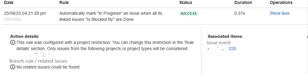

Hello @Lakshmi CH
Can you share with us the information you are getting in the rule Audit Log when you mark the last of a one of the "is Blocked By" linked issues to Done?
The output when you set any of the "is Blocked By" linked issues to Done, whether the first, second, or last, would also be informative to helping us debug your issue and advise you.

Thank you for the quick response, The ticket in the audit its showing is for blocked by ticket not the main ticket, but it should change the main ticket, when the all blocked by tickets are changed to Done.

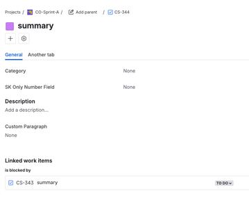

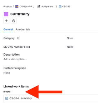

When you view the details of one of the issues under the Issue Links area, in that issue's Issue Links area the "main" ticket will be listed. What is the link type description shown there, describing the link from the blocking issues to the issue it blocks?
Example:
View from main issue:
(my images are taken from Jira Cloud so they may look a bit different)
View from the issue that blocks the main issue:

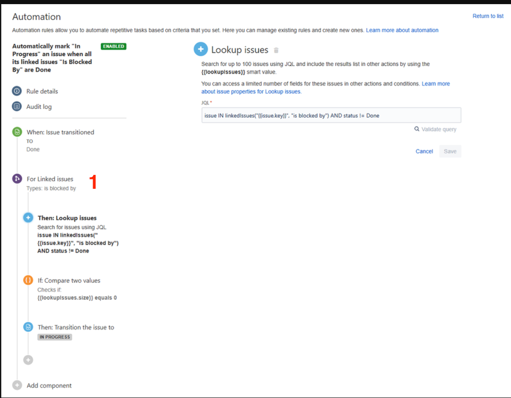

In your rule at the step I labeled with "1" you need to use the link description that shows up in the issue that Blocks the main issue.
