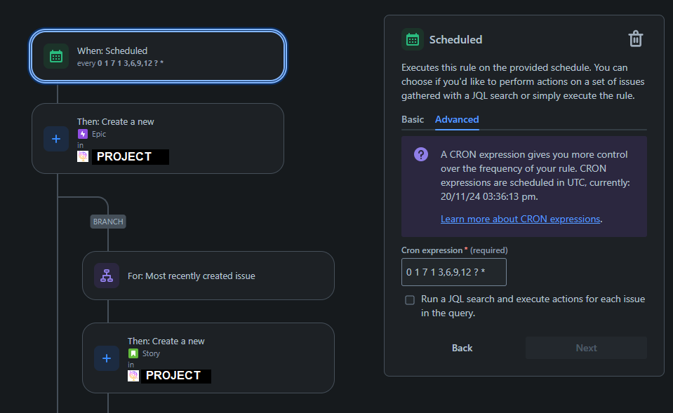

I'm reaching out to see if it's possible to have an automation run that will create quarterly & semiannual tasks within the same automation.

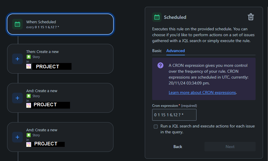

I currently have two automations running, one for seminnual and one for quarterly. The quartly one also creates an Epic that both kinds of tickets needs to be children under.
Here are the automations as they're currently configured:
Quarterly:
As they're currently configured, we need to go into the semiannual items and manually adjust their parent values to be the Epic that was created under the Quarterly automation.

The schedule expressions for your rules ensure they will occur hours apart (on the overlapping days), with the Quarterly one happening at 0700 and the Semiannual one at 1500.
First, you could create a single rule using the Quarterly schedule which first does the quarterly work and then uses a Smart Value Condition to check if the date is also time for the semiannual work to do that as well.

Next, the current schedules seem like a long separation time between rules, potentially creating a situation where people may manually update the issues.  Have you considered running them earlier in the day, and with only an hour of separation time?
Next, your Semiannual rule could be updated to use the Lookup Issues action with JQL to identify the correct parent, eliminating the need for the manual issue updates.
