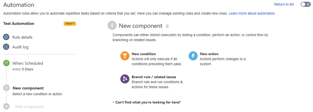

That aside my UI looks a bit different to what you put in the link and this is what I keep finding. Here's an example of the UI:
An example of the difference is I can't find any reference to "Smart value". From what I can tell this might be "Create variable"? But I'm unsure. Perhaps that helps with identifying how to do this within the version I'm on?
Yeah, sounds like (and looks like) you are on DC. You can still post here, but when you post, let them know it is Data Center.
So, that means that some things will be different. Not sure of everything. In this case the Smart Values thing is the branch. You can probably get by with a different Branch type. Maybe use the JQL branch type for now and use the same JQL from the Scheduled JQL. Click off the Only include issues that have changed box.
But see if you can do all of the rest.
