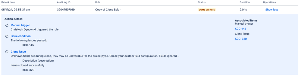

So far, this works, and everything is cloned correctly. However, the description is not transferred, and I receive the following error:
Unknown fields set during clone, they may be unavailable for the project/type. Check your custom field configuration. Fields ignored - Description (description)Here is the automation I have implemented:

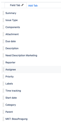

After i searched for every field Configuration, i found out that the description was removed from the create Issue Screen.
That was the mistake.

I had a similar error when trying to clone attachments. Your comment provided the solution to my error - Thanks you!
In my use case...
When the attachment field was not on the create issue screen and I had checked to clone attachments, the automation did raised an error in the automation audit log but did clone the attachments anyway.
When I added the attachments field to the create issue screen it cloned the issue with attachments without an error.
However I would think that the clone action should should clone attachments without error because there can be attachments on an issue that were not added on a create screen. I would think the same for your use case of "Description".

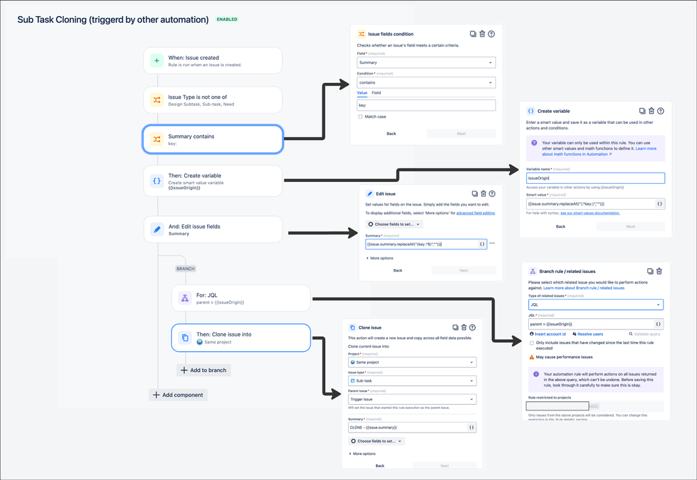

That solution approach requires multiple rules, so ensure you post all the rules and logs, identifying them accurately. Those will provide context for the community to offer ideas. Thanks!
Until we see those...
That solution approach (with multiple rules adding / removing text from the summary) could have execution timing problems. Your rules could also be incorrectly accessing the Description field, as that error message seems to indicate multiple fields named Description. Please also check if that is the case.

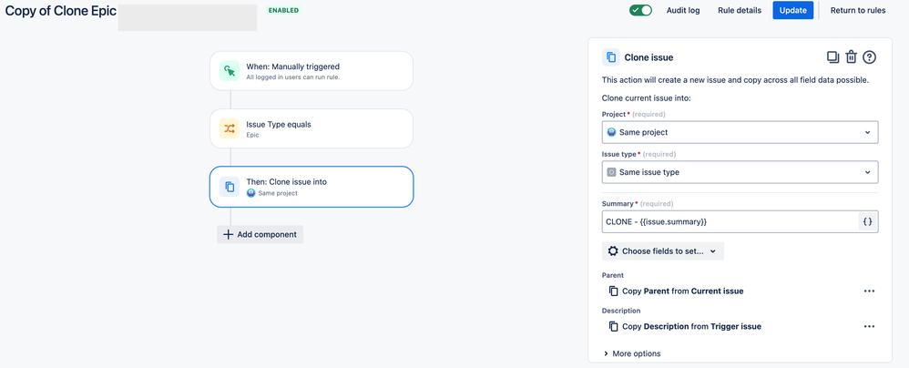

As asked you will find the automation rules here.
To reduce the complexity of the Automation, i created a new one that should just clone an Epic with all prefilled Fields like Description, Assignee, Reporter from the Template KCC-145.
In Jira Software the Automation works perfectly, in Jira Work Management i get the issues with the Description.

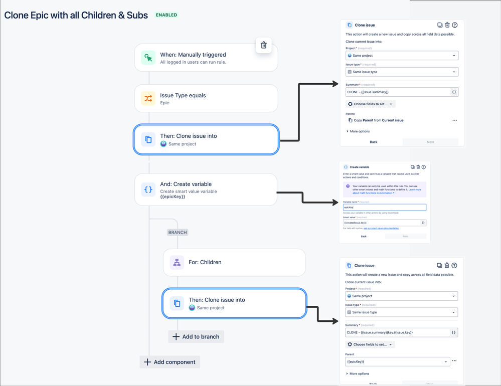

The whole Automation with Childern & Sub Tasks just FYI.
Exptected Result:
- clone the Issue KCC-145 with all prefilled Fields.
- clone the Children with all prefilled Fields
Bug:
- The Descirption is Empty
The Rule to Clone the Epic and Tasks:
