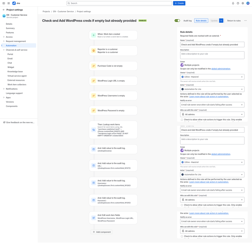

I have a question that is probably simple, but I can not figure it out and would appreciate the help of the Atlassian community.
It is on a JSM project.
When a work item is created:
  • browse if there are existing work item from same reporter (OK)
  • go through all existing work item from this reporter (foreach branch) and check if a specific custom field is not empty (OK)
  • copy the value of this custom field (from the work item of the foreach) to the work item that triggered the rule
The last part is where I struggle.
  • I have tested with "Edit work item", but it edits the work item of the foreach branch.
  • I have tested with "Set issue property" (but it the property is associated to the work item browsed in the foreach branch, not to the work item that triggered the automation).
It seems to me that it should be rather simple, and that I am missing something...
With many thanks!
Céline

Hi @Céline - Maestrel
Once the rule is inside of the branch to work items, the scope is now those work items: it cannot edit the trigger one.
Perhaps use the Lookup Work Items action with a JQL expression to find the ones you need, and then reference the {{lookupIssues}} smart value (outside of branching) to update the trigger work item.
Bill

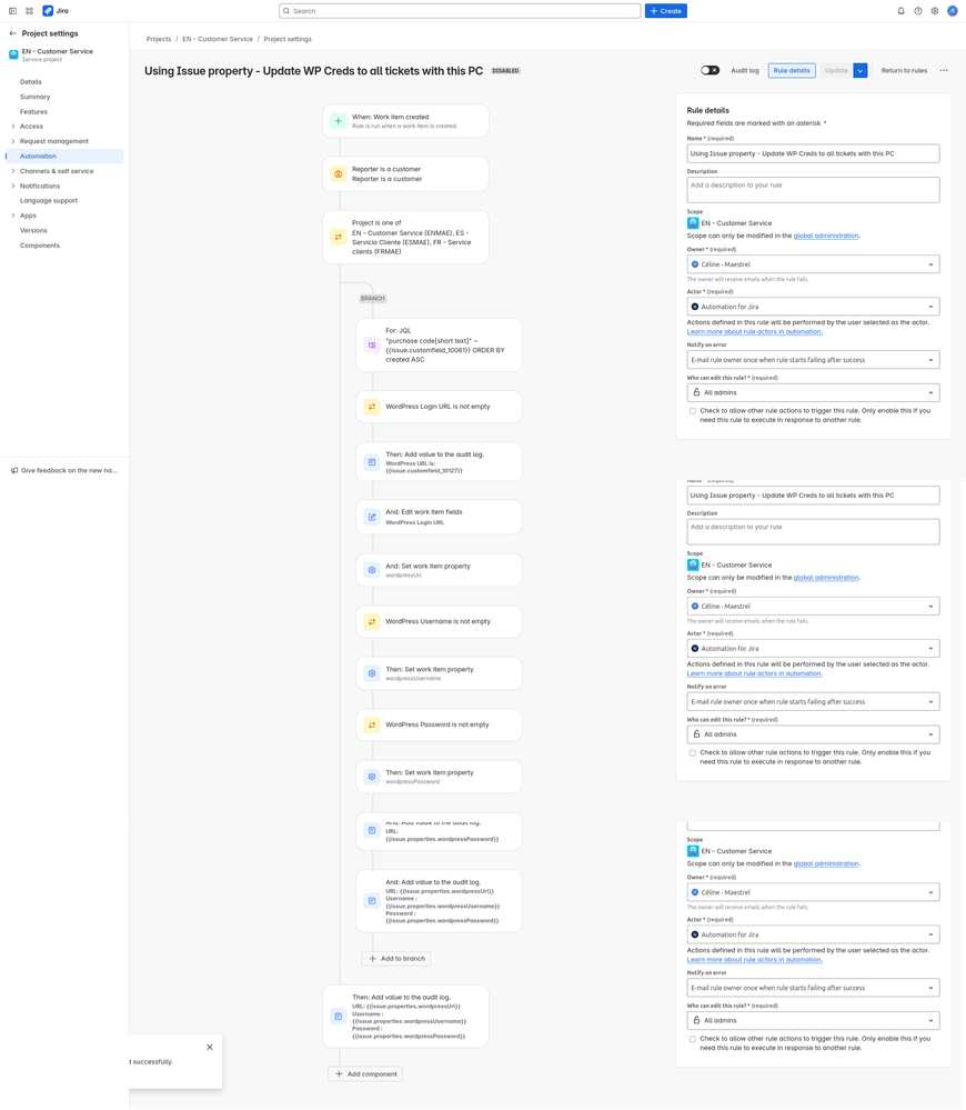

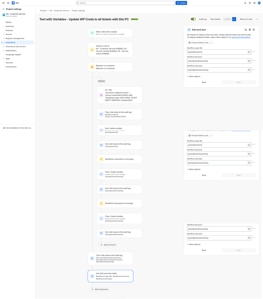

I have as well tested to use Variables (as it seems more appropriate than Issue property), but I still can not make it work...
Rule - Using Issue property
Rule - Using Variables
Results of both rules
For both rules, I have the correct values logged in the branch. I know that I have retrieved what I need. However, I can not figure out how to use these values to update the work item that triggered the rule  (the one not in the branch), to be updated with these values.

In other terms, here is a summary of my different questions:
  • how do I set a value for a field of the work item that triggered the automation, when I am in a foreach branch that loop on other work items?
  • how do I use a variable (created in the foreach branch) to set the value of a work item field as the value of the variable? I wish to use the variables outside the branch.
  • Additional question : in my context, would it be best to use "Lookup items" rather than a SQL condition with a foreach?
Thank you!
