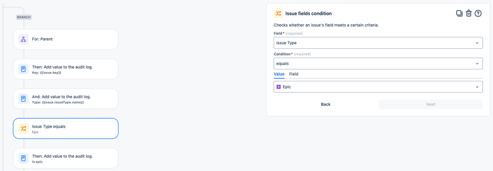

I have a trigger "When: issue transitioned".
I want to check if the parent is an epic, and if so continue with my flow.
This is what that part of my branch looks like:

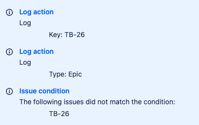

But when the rule gets triggered by a child with an epic, the step fails, even though in the logs I can see the issue type is an epic.
The log "Is epic' does not show up.

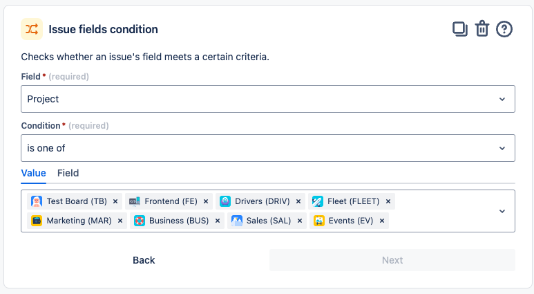

First, not sure why that does not work. But, maybe you can work around it by adding a Condition right after the Projects condition to check for the Issue Types that would have Epic as a parent. Also, if you create the rule to be a Multiple projects rule and select those projects in the Rule Details, you shouldn't have to do a Condition here to check the Projects.

Hello @Trudy Claspill ,
There are multiple projects, they are all "Company-managed software".

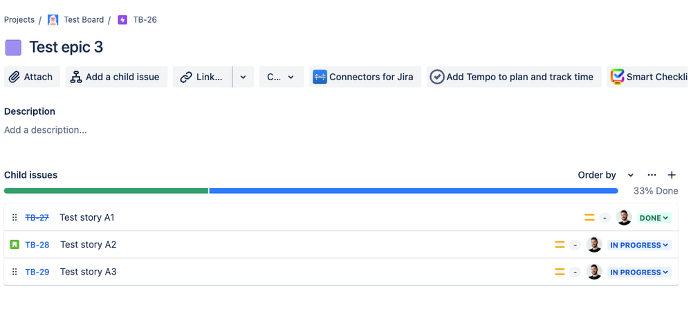

The epic and story I am testing with is this, I am changing any of the story statuses:
This is the basic setup:

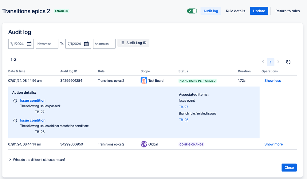

And the result from the audit log:
Do you spot something I did wrong?
