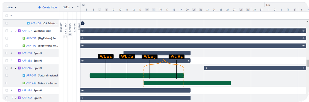

We have stumbled upon a specific use case. Let's say there are two issues - APP-247 and APP-248 and User A is assigned to issue APP-248 (and this issue has Start date set). While working on APP-248, the user has also logged some work on APP-247. I/the client would like to get a report displaying only those worklogs from APP-247 that have started after the start date of APP-248 (see image below - in this example, we would only like to write down worklogs "WL #3" and "WL #4"). The 'report' could actually only be text field on APP-248 issue that contains this information.

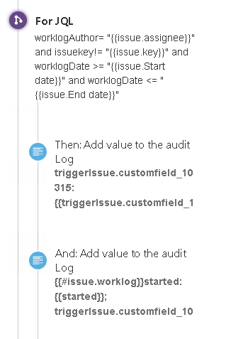

We've started to build up an automation for this and this is what we have so far...
First we have a branch that finds all issues where the person who was assigned to a trigger issue also logged time after the "Start date" of an trigger issue (this works fine 👌).
Next, for each filtered issue, we go through the worklogs by using {{#issue.worklog}} smart value. The problem occurs when we try to fetch {{triggerIssue.Start date}} smart value within this iteration - it seems that system cannot 'handle' that - meaning you can only get values from iterated worklog (e.g., author, started date...) but nothing out of that scope.
I've tried logging the following phrase:
{{#issue.worklog}}started: {{started}}; triggerIssue.Start date: {{triggerIssue.Start date}}; IF: {{if(started.isAfter(triggerIssue.Start date), "true")}}{{/}} but as you can see in the screenshot below, outside the iteration smart value properly shows trigger issue date, while inside the iteration it does not.

This is a known limitation of automation rule, list iterators: they can only access data from the scope of the iterator, and lower. They cannot "see" other issue fields, created variables, branch variables, etc. In a few different posts, I have read Atlassian engineers tried to fix this limitation but were unsuccessful.
Depending upon your Jira version, a complicated work-around is to use in-line, text matching functions instead. The idea is:
The "trick" to make this work is to build the dynamic, match expression first, such as in a created variable or custom field. That may be used as :
{{varCompleteList.split(",").match(varSearchExpression)}}
Another work-around is to perform such actions outside of the rule, by creating a service in another programming language, passing the issue data or keys, and then calling that service with the Send Web Request action.
Regarding using the isAfter() use in a list filter, I have observed inconsistent results even when using a literal value. Perhaps instead use the gt() function and format the dates to allow comparison, such as yyyy-MM-dd.
Bill
