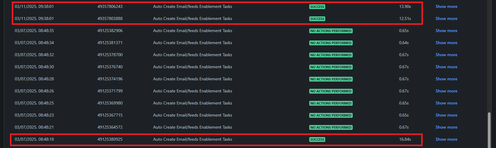

Here's a snippet from the audit logs showing that there were no config changes between the last successful run (single run) vs the most recent run (duplicated):
I've reviewed all audit logs for the offending issue key and there was only a single automation that kicked off against it (expected). So I'm not sure if this is something that I need to make adjustments on the automation or something else.

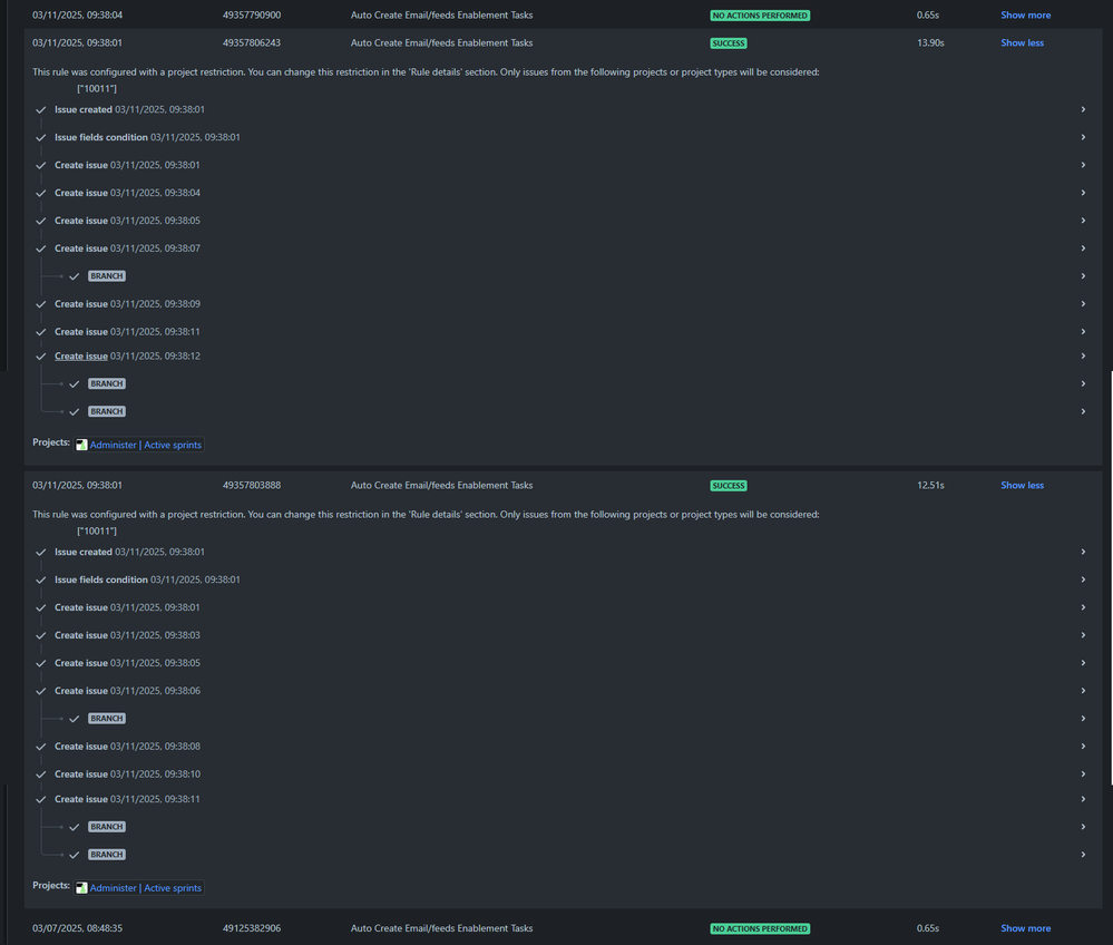

I did confirm that the expected field isn't being set by any of the created tickets - although the field is available for use. I've added a Re-fetch Issue to the automation to help slow it down, but the results are the same.

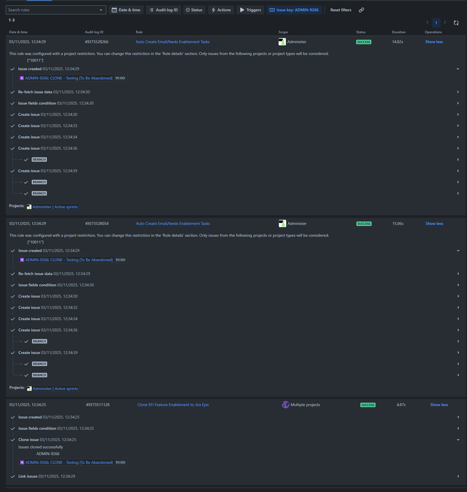

I looked in the Global Automation audit log to see if the most recently created item had more than one rule triggered against it, but it's just the original rule that creates the ticket + the duplicated rule:
As written and with the "Check to allow other rule actions to trigger this rule..." option enabled, the rule will definitely trigger multiple times if the created issues are in the same scope as the rule.
The questions are: which issue is doing so and does it perform any unexpected processing?
For the two most recent executions (where you only expected one):
I would've expected two different issues to trigger the rule - seeing as it was triggered twice, but there's only one issue that triggered both:

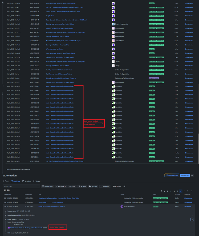

First, please remove the filter at the top on ADMIN-9266 and check the log again to observe how that changes what you see...particularly how many rule executions happened after first triggered by the creation of ADMIN-9266. You may need to expand several executions to check which issues were involved.

Here's a snippet of the audit logs from immediately after the initial creation. From what I can see, nothing else ran between the two:

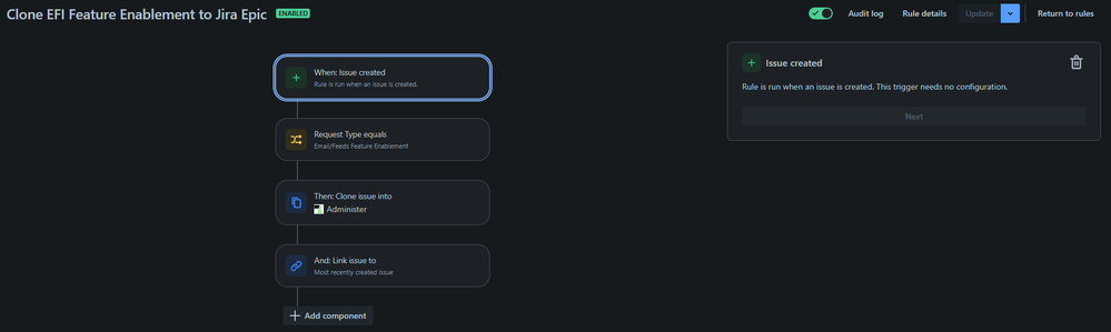

Here's the rule that generates this ticket:
I did confirm that "Check to allow other rule actions to trigger this rule." is not enabled.
I thought you wanted that option enabled so the other rule creating the issue will trigger this one? Which is certainly okay; just gotta track down the problem.
Based on the logs, there is something causing the issue-created event to be fired at least twice for the same issue, leading to the rule starting multiple times.
I just checked the public backlog and I did not find this symptom for the Issue Created trigger (although it exists for other triggers). However, Atlassian is actively rolling out a new retry capability which automagically attempts to correct temporary system problems with rule actions. I wonder if there is an edge case for your rule set causing this result.

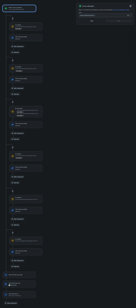

Apologies I should clarify. The Clone ticket automation should not be triggered by another automation, but the Tasks ticket does need to be triggered via automation.
The Clone ticket automation is the initial one, which should only create a single ticket - that's working as expected. The Create Enablement Tasks is the one that needs to be triggered by the Clone automation.
As of right now, the initial step is working as expected (original ticket is cloned to a new project) but the second step doesn't work quite right anymore (create Tasks under the newly created clone ticket).

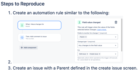

I appreciate the additional input. I had brought up a similar concern that while the results were the same the cause was not. This is the information they provided - although it still doesn't entirely align with the existing bug ticket:
While the bug mentions the 'Field Value Changed' trigger, we believe that the problematic behavior is due to the Parent field. As seen in the steps to reproduce below, the problem occurs when the 'create issue' operation is being called with Parent defined data:
I have added an internal comment to this bug asking that we either update the Summary or spin off a new bug, linking it to this existing one.

I rebuilt the automation that was originally kicking things off and I haven't seen any duplication of Tasks since it was rebuilt.
Original automation:
Rebuilt automation:
The new automation was built out to intake form data which the original did not need to have as it was just using the fields provided in the Request Type setup.
I don't have the "Action: Clone issue" any different than the original one; however the trigger here is different. I've tested submitting the request connected to this form and confirmed that the automation that kicks off the tasks is only getting triggered once instead of twice. So it's back to working as expected now!
