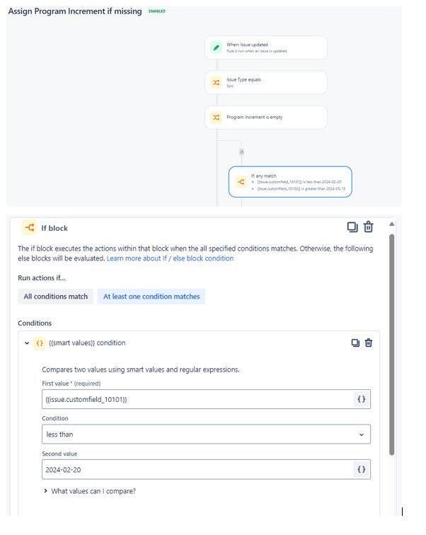

I am working on an automation rule that will used the planned start and planned end dates to determine the Program Increment that an epic is aligned with. An epic could start in one Program Increment and end in another Program Increment, and I want to select both values. The field Program Increment is a multi-select field. The planned start is customfield_10101 and planned end is customfield_10102. The logic is working for the most part.
I am using If/Else statements to determine if the start date is after a specific date or the end date is before a certain date if it is select a specific PI from our list of options. This works but is only selecting the PI for the latest End date.
An example is I have and Epic that has a planned start in the middle of Program Increment PI2 2024 and a planned end date in early part of Program Increment PI3 2024. This epic is only getting set to PI3 2024 when I want it to select both PI2 and PI3.

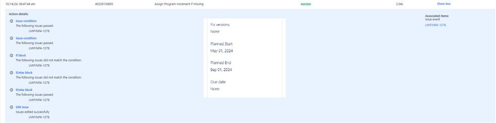

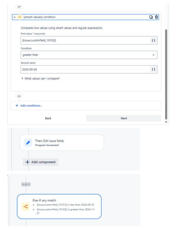

Here is a copy of the log for an Epic that should have PI1 and PI2 2024 just based on the planned Start and Planned End dates.

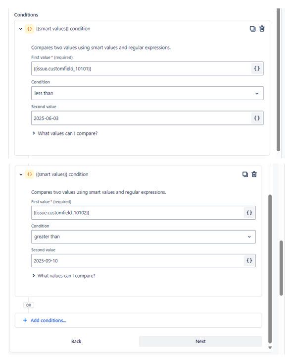

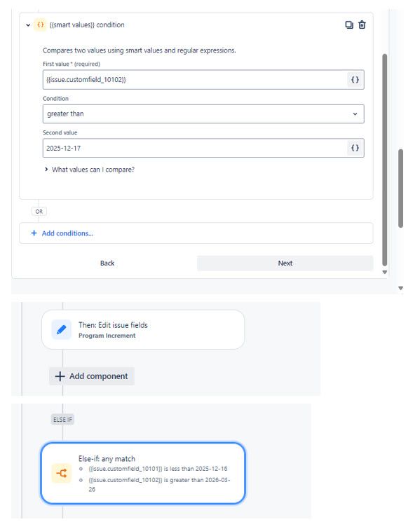

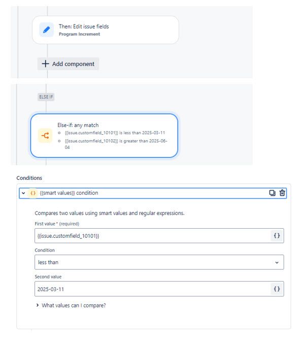

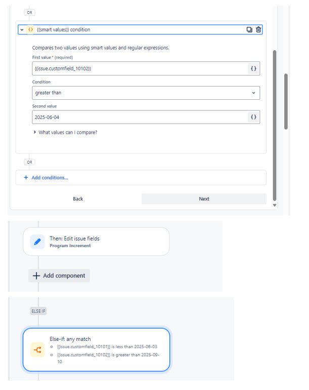

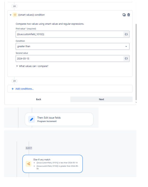

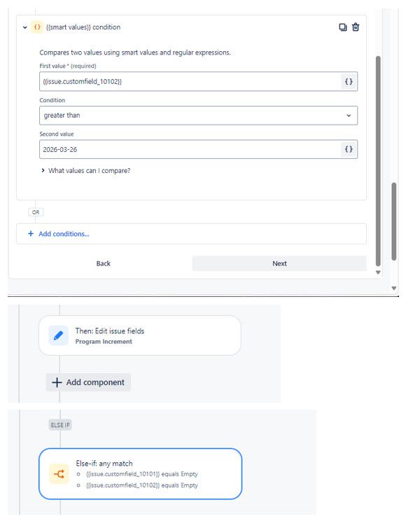

Here is the full automation rule sorry for being so long it is 8 increments with repeating logic.

From the audit log image you show, it appears there is only one edit of the issue fields. Is that correct?

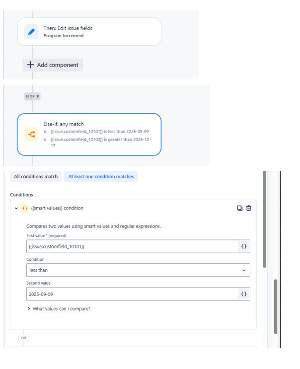

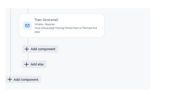

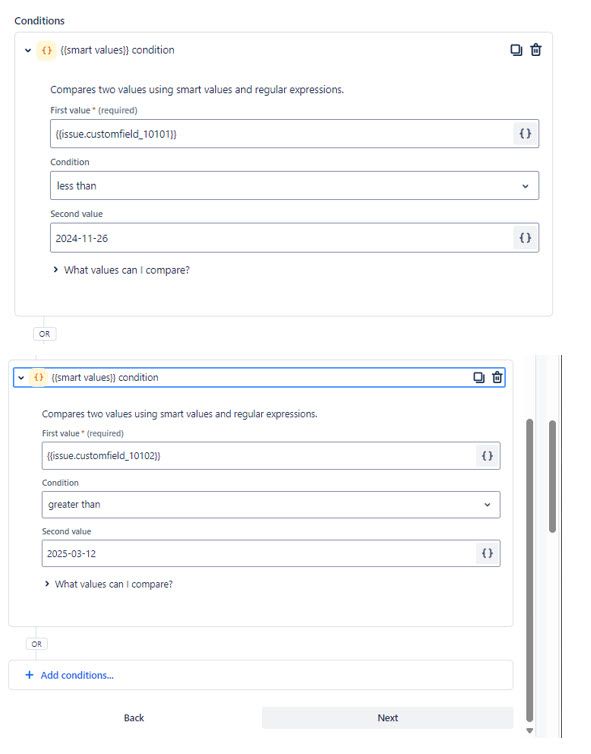

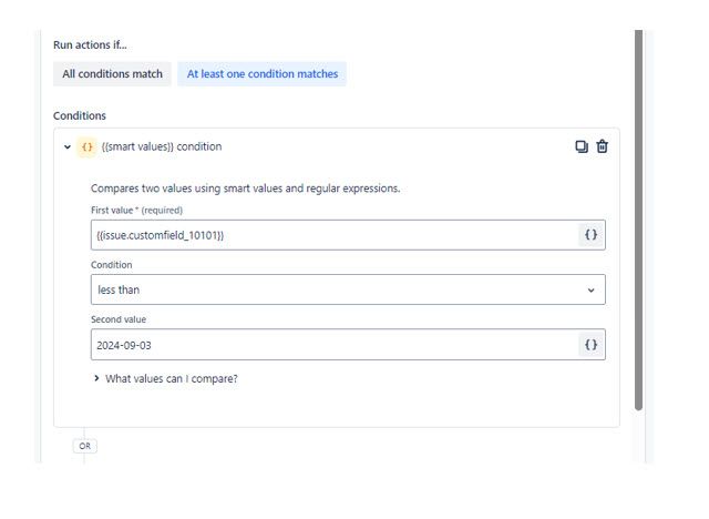

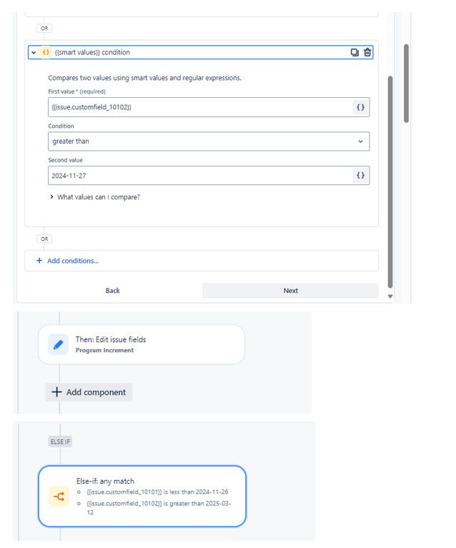

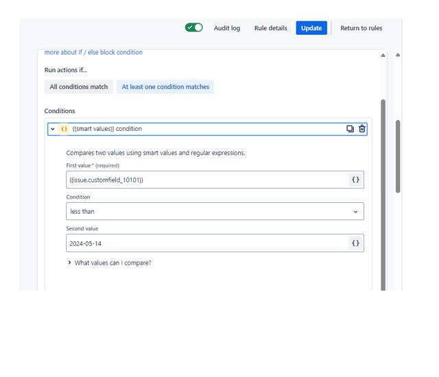

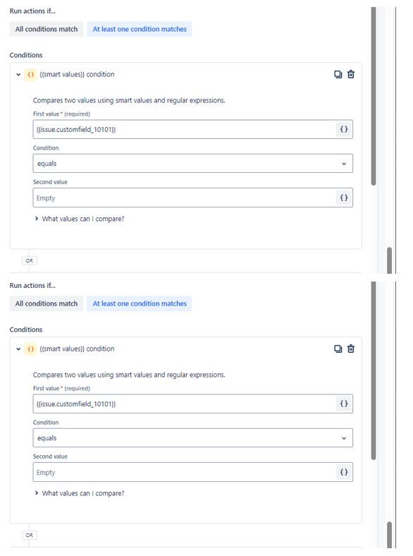

I hope these are better I had to break it down into a series to make it readable.
Thanks; that helps a bit. First thing to try:
Those advanced planning, date fields definitely cause challenges in rules. And, comparisons of date / time values are tricky unless you take total control of them.
When you use the custom fields in the comparisons, force them to an exact format which will be comparable as text with your manually typed in values:
{{issue.customfield_10101.jiraDate}}
{{issue.customfield_10102.jiraDate}}
Those will match what you are typing in for greater than / less than checks.
Next, I recommend making a list to confirm the correct order of your conditions will match what you expect...leaving no gaps in the logic. Then create test cases for each one to exercise your rule.
@Bill Sheboy thanks I did add the logic for jqlDate for each greater than/less than condition. I do have test cases for each PI as well as for overlapping PI's. With the change to the logic, it is now assigning the PI to the first PI that passes the logic and ignoring all the rest. I may have to come to grips that this may not work without a Jira add-on which are not getting approved at the current time where I work.
