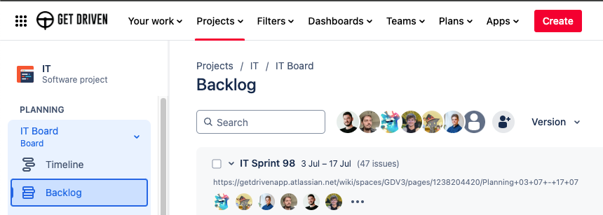

I have an automation which creates some tickets in a new sprint, after completing a sprint.
I noticed for two sprints already, this has not been triggering anymore, even though it used to work on other boards (the IT Board is a new board).
For example today I completed and ended a sprint, this sprint just started

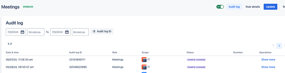

But in the audit logs it does not appear for the automation

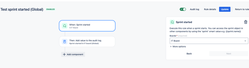

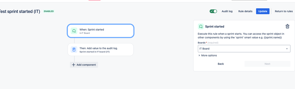

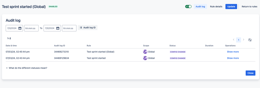

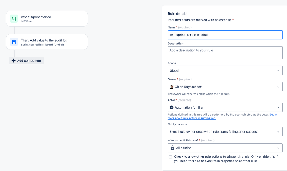

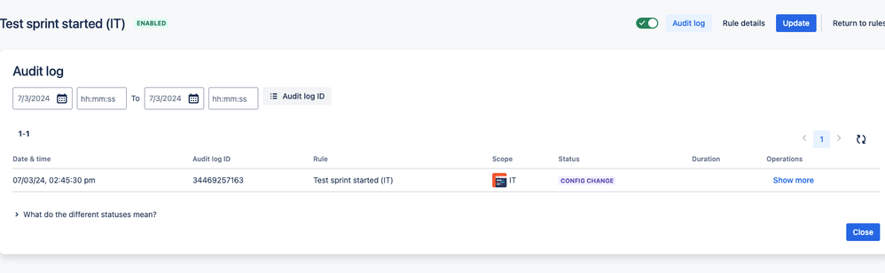

To double check I created 2 test automations, one with global scope and one with IT scope. These would print a log when the sprint starts.
After starting the sprint, they did not run.
Global:
IT scope:

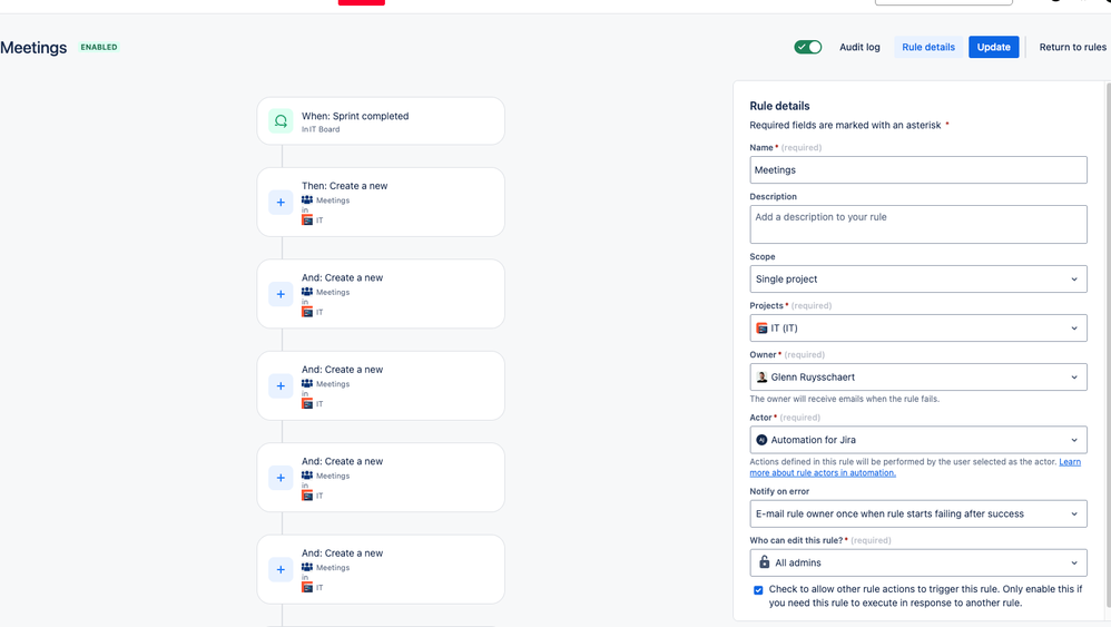

Hi Glenn,

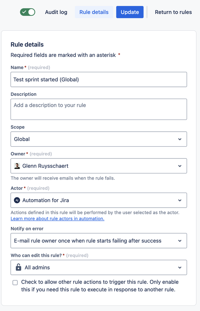

Not sure what might be happening to trigger the new Sprint, but it might be that the automation rule is checked to be allowed to run when something else triggers it. Take a look at the Rule Details and see if the box is check to allow it to be triggered by another option.

With "allow other rule actions to trigger this rule", the rule does not get triggered.

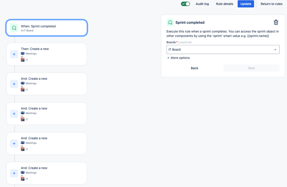

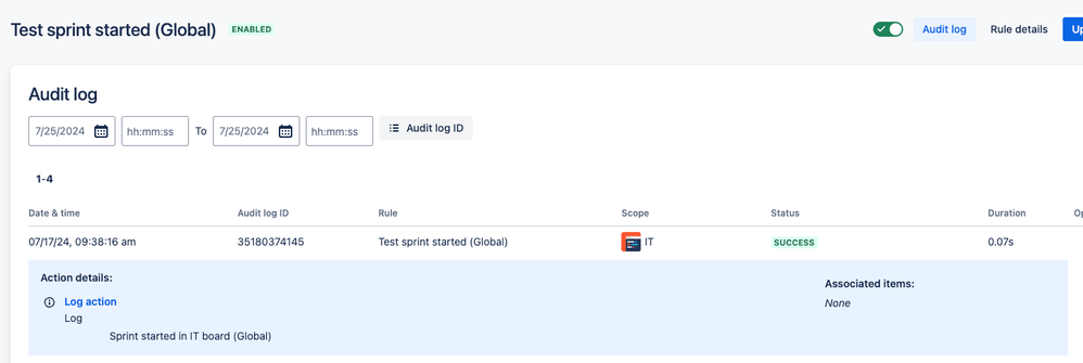

I have a test automation in place:
This one got triggered

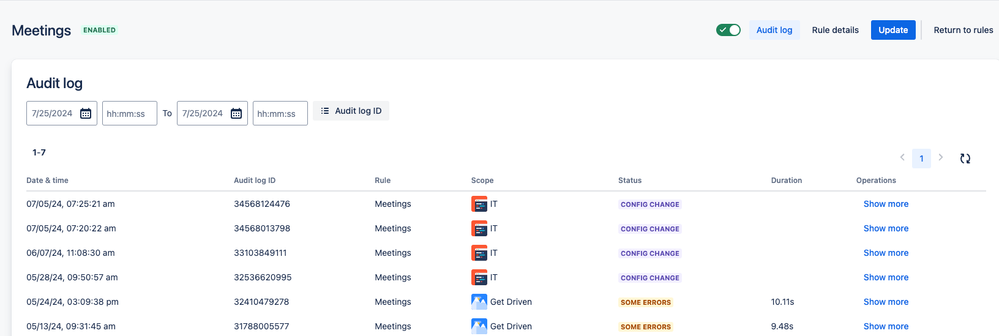

But the automation that should trigger, does not:
Any ideas?

I set up the "Test sprint started" automation, as evidence that when I close a sprint it gets detected. All it does is log the sprint.
But the other automation, does not get triggered (along with some others that are very similar, they all just make some tickets for the next sprint).
So now I have evidence (because of the test automation), that when I complete a sprint, it triggers automations. But for some reason, not all automations get triggered and I can't understand why.

I have now changed the scope in rule details for the automation that is not triggering to "Global", with the when sprint completed still on the "IT Board".
When this sprint completes, I will check again (as this sprint is currently in use by the team).
I will post the results when I know more.
