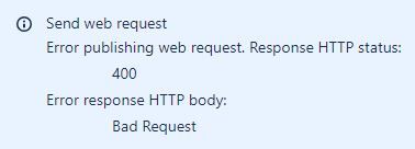

I am using a PUT API call to change the version's name field upon release but the following error keeps appearing:
Error publishing web request. Response HTTP status: 400
The URL I am using: https://MyCompanyName.atlassian.net/jira/rest/api/3/projects/ProjectName/versions/{{issue.fixVersions.id}}

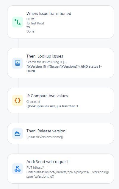

You can check current flow here:
Any help would be very much appreciated, thanks!

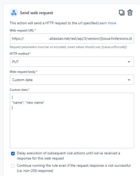

@Alex Cadevall , Welcome to the Atlassian Community!
According JIRA API REST documentation your URL is wrong. Please, try to use this URL: https://your-site.atlassian.net/rest/api/3/version/{{issue.fixVersions.id}}
I did some tests and works fine. Consider this documentation to Fix Versions API in Jira Cloud: Update Version - REST API
If you want change only the name use this custom payload:
"name": "NEW RELEASE NAME"
Hope this helps you.

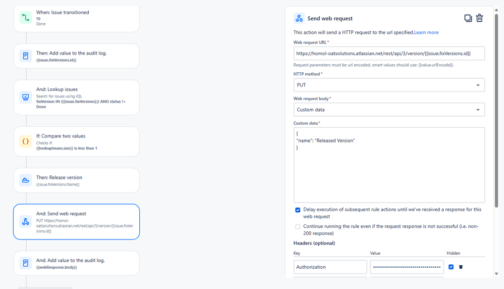

@Alex Cadevall
Have you checked your token or your permissions in the project where this version is presented.
Ensure that you are in administrators project role or consider try another Jira API TOKEN. I'm leaving an attachment of my rule that is working so you can just take a new look and see if is similar to this one. Then you can try to change your API token to see if your the current problem is associated with your token or permissions.
Hope this helps
Alex Cadevall January 10, 2024
It was indeed the token, thanks a lot for your help!
Yes, it was both a URL problem and token problem.
For the URL I had to simplify it to the one indicated by @Fernando Eugênio da Silva URL: https://your-site.atlassian.net/rest/api/3/version/{{issue.fixVersions.id}}
Regarding the Token I had not added Basic in front of the base64 coded email+token.
Thanks a lot for your help!
