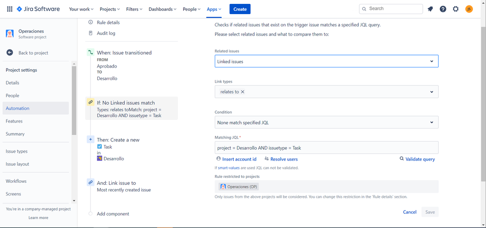

Create an automation so that when an issue transition to status "a" "b" create a task (in another project) and link it.
But on the condition that if it already exists, do not recreate it.
Believe this:
1- Issue transitions "Approved" to "Development"
2 -If matches related issues "related to" condition None match specified  (JQL)project = Desarrollo AND issuetype = Task
3-Then Create a task in project ...
4-And link to most recently created issues
But when you rerun this automation, it re-creates the task?
Thanks !!!!

Hi @Jonathan Santos
Yes, and...to what Bryan asked about:
Your JQL in the related issues condition seems to cover a lot possibilities.  Are you certain you only want one Task in that other project?
And...I have not always found the related issues condition reliable, so perhaps try another way to see if that helps.  Replace that condition with
  • action: lookup issues using your same JQL from the condition
  • condition: {{lookupIssues.size|0}} equals 0

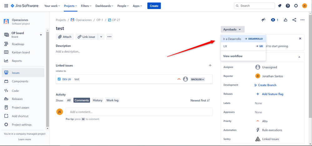

@Bill Sheboy
Thanks for your support, but i can't find my mistake:

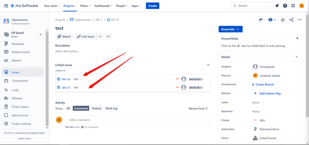

My request is as follows:
When I transition a task from Aprobado to Desarrollo in the "Operaciones" project, you have to create a task in the "Desarrollo" project and a "related to" link, but if this transition is made again by mistake, this task is created again, then It is duplicated, how do I create a condition for it to validate if it doesn't have a task linked to related to?
1-Issue tipe task transition "Aprobado" to "Desarrollo" (Project Operaciones)

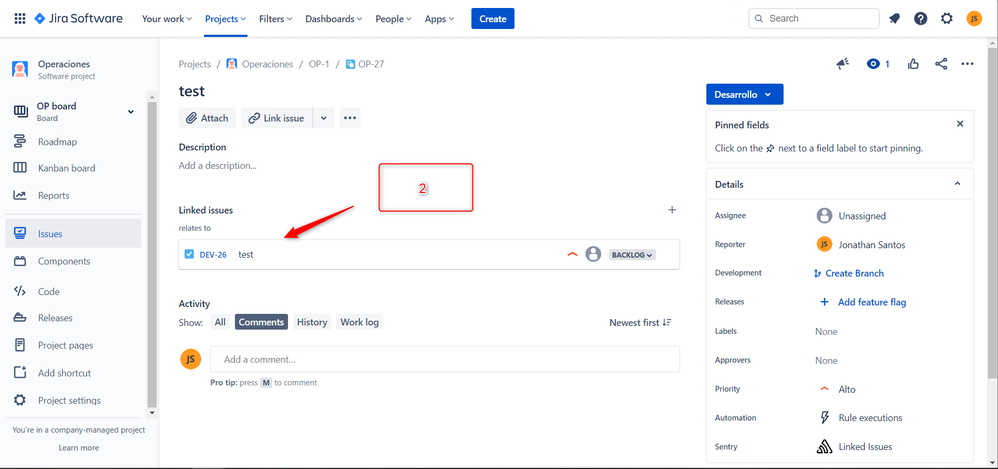

2-Create a Task in the project "Desarrollo" and link to trigger issue link "relates to"2021-11-13_00h59_30.png

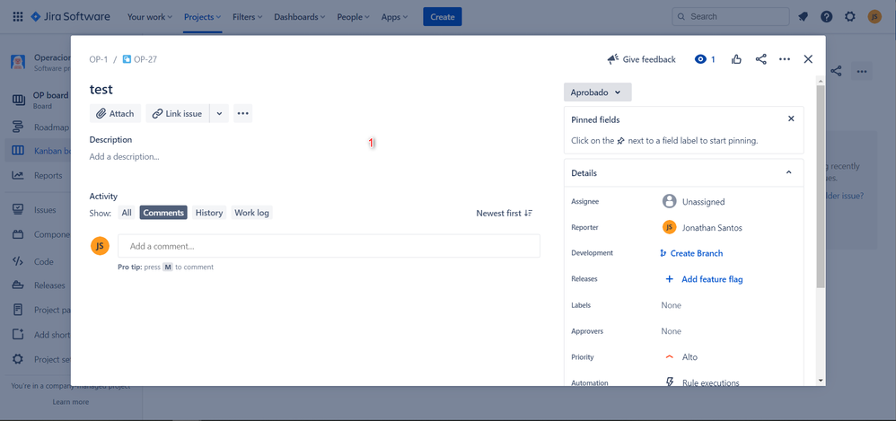

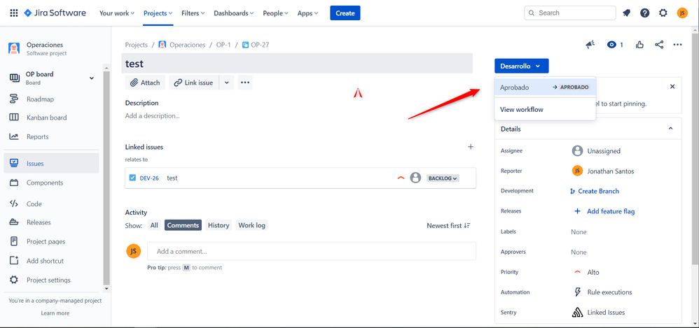

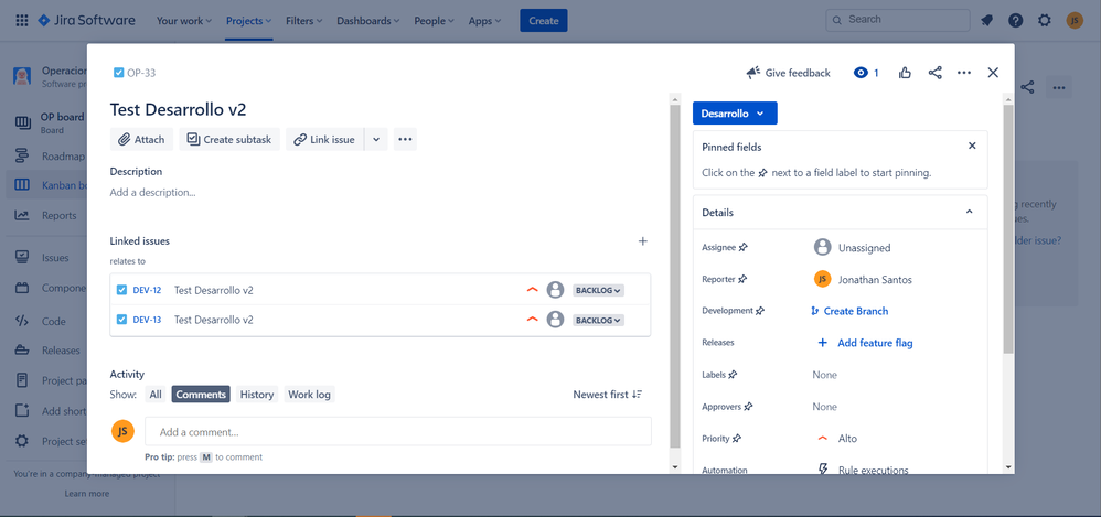

5-Create the task and its link again, this should not happen since it duplicates the task, what condition do I have to create in automation2021-11-13_01h08_24.png
Thanks !!

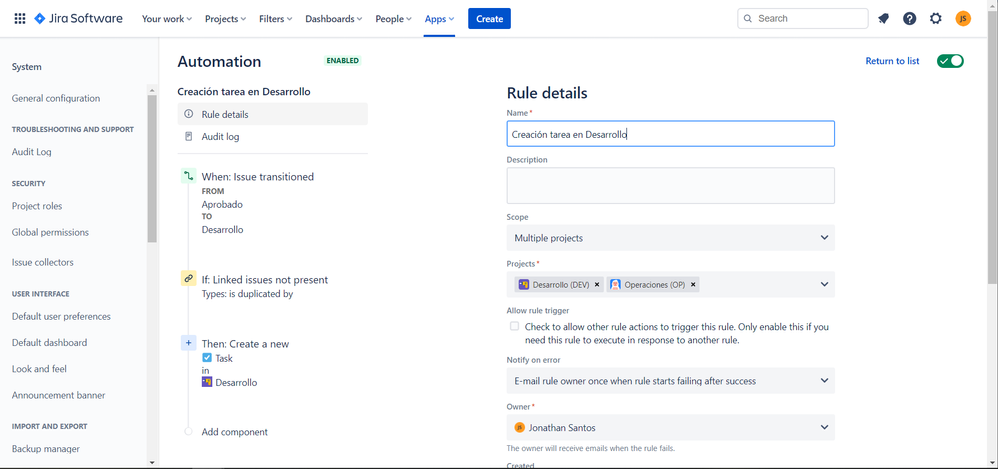

Jonathan Santos
November 13, 2021
Hi @Bill Sheboy @Bryan Trummer - ReleaseTEAM
I was able to solve it, I just needed to add the other project where the task is created.
Thank you very much for your help, they guided me in understanding the automation logic.
