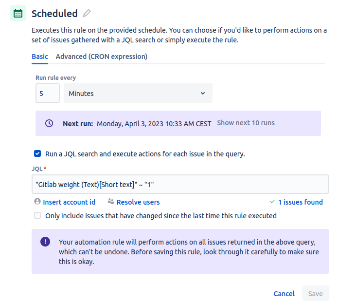

I'm trying to run automation to move data from a custom field (type text containing a number) to "Story points estimation".
This is my automation settings:

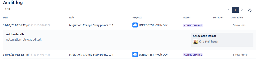

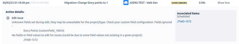

However, audit log shows following error:

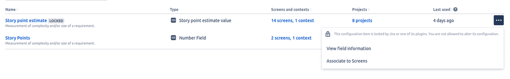

The "Story point estimation" field is part of the project and screen, but I see a "locked" label next to the field in the "Custom fields" overview - it says "This configuration item is locked by Jira or one of its plugins. You are not allowed to alter its configuration."

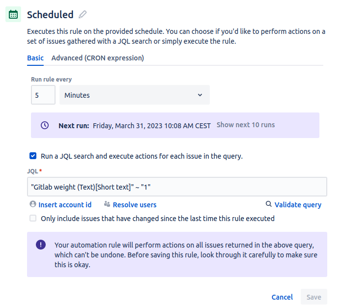

As you can see, this automation move data only for fields with value 1. But is there a way to move data from all custom fields, regardless of the value?
The Gitlab weight (Text) field can contain 1,2,3,5,8 and 13 as values and I would rather set up only one automation instead of 6.

By chance does your project have 2 fields "Story points" and "Story point estimation" that is causing a confusion?
The automation is editing the story points field and the story point estimation field
No, actually there is only one "Story points" field.

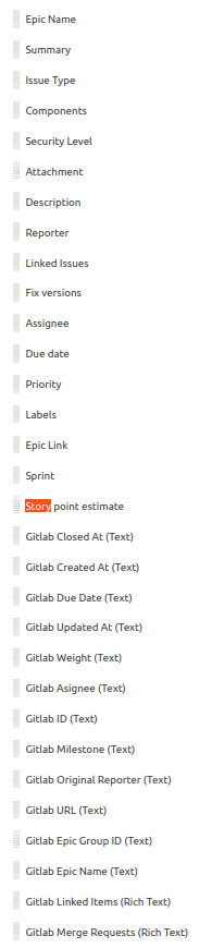

This are all the fields I have in my screen:

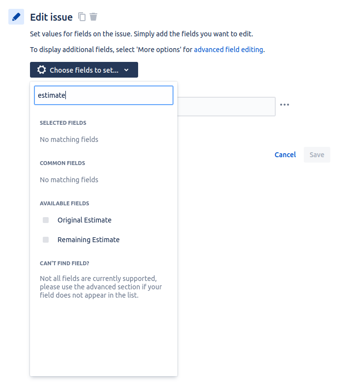

In your edit issue action screenshot, you are using "Story points" . Update that to "Story point estimate" and that should fix the error :)
Well, thats the point. There is not "Story points estimate" :/

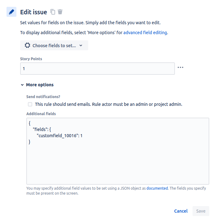

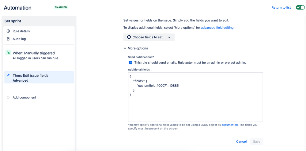

Ah ok.. Like it says there, not all fields are supported. Try using the advanced section with json as input
Ok, I had a quick look at it, but don't understand what I should do there. Do you maybe have an example?
sure, here is an example of using additional fields via json
Thanks, looks quite simple, but the automation doesn't trigger now. Its even not showing any errors, only "Config change":

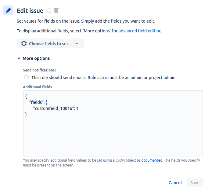

I tried this:
And this as well:
hmm.. If the rule is not triggered, could you look at the trigger condition? was there any changes there? Is the jql valid?
try it as a manual trigger and validate?
The rule is actually valid, 1 issue found. And no, there were no changes during the whole time.
