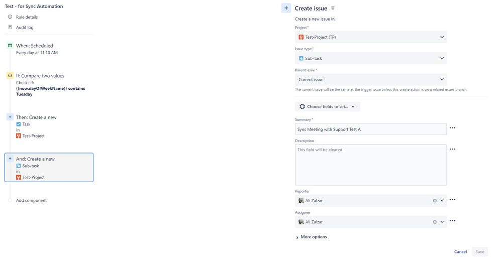

I've been trying to create a Task with 3 Sub-Task through Automation but I keep getting the following error:
Action details:
Create issue
Issues created successfully
TP-108
Create issue
Error creating issue
Issue type is a sub-task but parent issue key or id not specified. (issuetype)
Here is my rule(s):
Here is my sub-task Action:

Hi @Ali Zalzar , welcome on the community :). You can try to use smart value {{createdIssue}}. It should store the last created issue in the rule:
https://support.atlassian.com/cloud-automation/docs/jira-smart-values-issues/ -> search for "{{createdIssue}}"

No, you need to write it manually to the Parent issue field. Check the screenshot I attached :)

Nic Brough -Adaptavist-
October 4, 2022
The problem is your choice of "current issue" in the sub-task settings.
There is no current issue in a scheduled task, you need to tell the automation which issue you want to create the sub-task(s) in.
