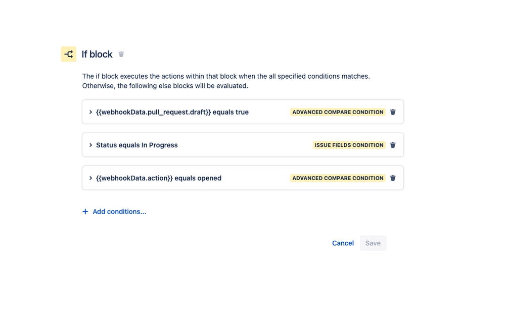

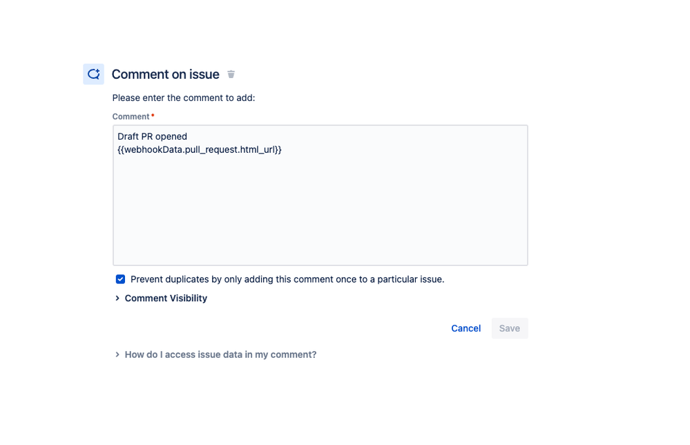

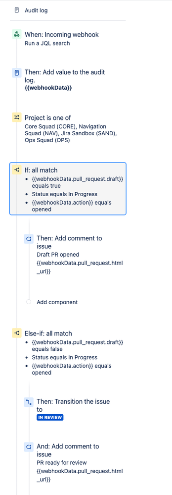

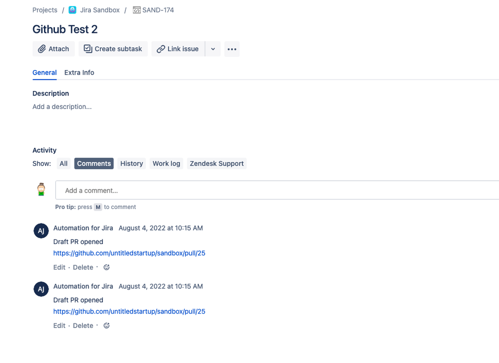

×I have automation to check if the Github pull request is opened as a Draft and not transition the ticket but instead add a comment. I see a single webhook on the Github side but the automation rule runs twice which is adding multiple comments (even with the prevent duplicate checkbox to only add a single comment).

Automation rule:
Ticket
Any ideas on how to prevent this? Thanks!

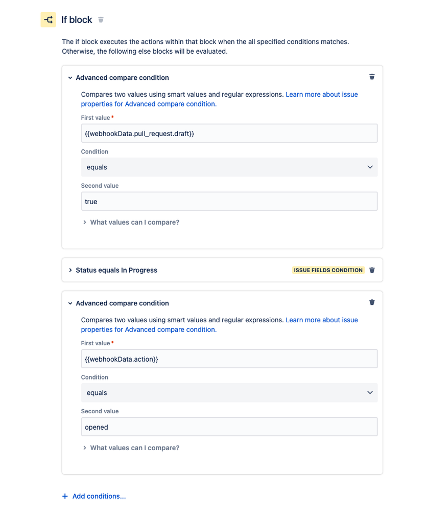

couldn‘t find your „pull_request.actions“ in the payload.
Could you also write those values that you are comparing to the the action log?
Furthermore:
Are the compared against string or boolean true?

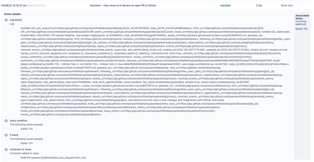

action log:
action: opened. Draft: true
Here is what I am comparing

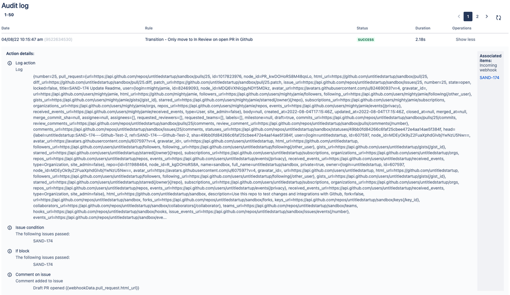

I think that once it fires, it's working as intended. I guess my question is why are there 2 entries in the Audit Log for the same ticket at the same time when only one Github webhook fired?
ah...I didn‘t notice it‘s writing exactly the same message twice. please appologize 🙏🏼
hmm....that looks really weird indeed. could you please share a screenshot of the audit log? what does the jql look like and what is the result?

I think I figured it out. I added a webhook to the Github test repository while testing and then when I finished, I added the webhook to the org but forgot to remove the test one. So I think the webhook was actually firing twice from Github but I was only looking at one queue. Removed the test one and things look promising. If not, I will grab the screenshots and any else I come across. Thanks for your help!
