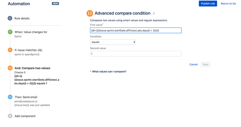

Thanks for the response John!
Could you please elaborate on what "{{#=}}{{issue.sprint.startDate.diff(now).abs.days}} > 2{{/}}" this would do?
Also, as per my understanding, this would work every time someone edits the sprint value in an openSprint, right?
This is what I set and I went ahead and created an issue but didn't get any email.
Hey Anand,
so with that string, essentially what we are doing is combining the date and math functions to determine if the current date {now} is more than 2 days from the sprint date. It's a little complex but it should work.

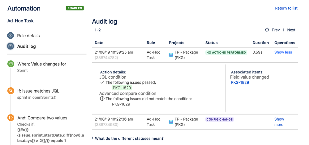

We will need to debug a little bit to find out what is going on.
Could you add a log action after the first condition using that string?
Also, could you add a debug into the compare condition? (this is just the info below)
{{#=}}{{#debug}}{{issue.sprint.startDate.diff(now).abs.days}} > 2{{/}}{{/}}
You can see more about the debugging here if you like.
Should be able to get to the bottom of it soon.
Cheers,
John
Hey John,
I've added both the log action and debug. Will send you screenshot if something is found.
Also, the sprint started on Tuesday (20th Aug) and today is Thursday (Indian Time). So I think our logic should work from Friday.
