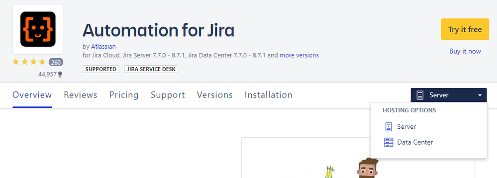

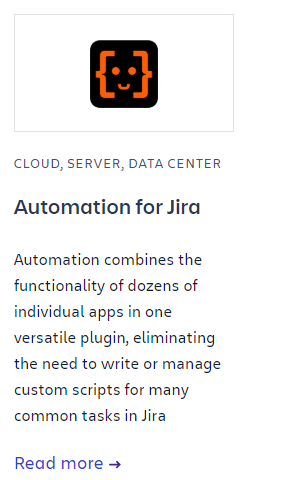

If I visit the Automation for JIRA Marketplace page here, the only hosting options are Server and Data Centre even though the Atlassian guide lists it with Cloud as an option.
The app was removed from Marketplace and is now part of Jira Cloud. You should see it if you go to Project settings > Project automation, or Jira settings > System > Automation rules.

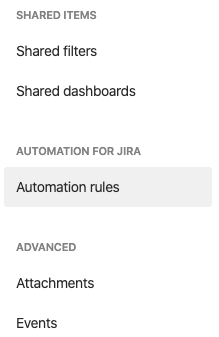

I believe it's supposed to appear between security and user interface, but it isn't shown in our settings.
It should be further down, almost at the bottom of the list:
