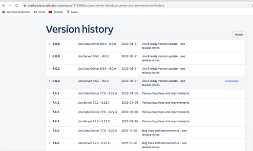

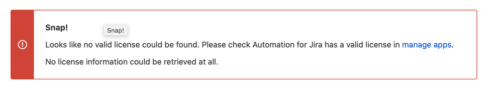

I installed Automation for Jira 8.0.2 on our Jira Software 8.7.0 server. The description of Automation for Jira says that it is free since version 8.0.0 and there is also one for Jira Server in the list of versions, and also Automation for Jira 8.0.2 is compatible with Jira Server 8.5.0 - 9.0.0 But after installation Automation for Jira does not work, I get a message that the license for the program was not found. At the same time, there is no "buy" button or "try" button, like for any other free or built-in program. Please, tell me what to do to make the Automation for Jira work!
I tried also to install 8.0.0 version - the same result.
Restarting the server doesn't help.

I'm having the same problem, running Automation 8.0.0/8.0.2 on Jira Server 8.20.11. Installation is successful, but then an error is generated when I click "get started."
I have the same problem, installed on Jira Server 8.13.3

I found out that Automation 8.0.x versions work correctly only with Data Center. With Jira Server they don't work correctly more, the rules cause errors, which means that Jira Server is simply not supported, despite the fact that it is indicated otherwise in the version list. Apparently, the mechanism of versions publishing has not been finalized yet. Accordingly, only previous versions of Automation, which are paid, can be used with Server, unless, of course, you can buy a license for them, because now the application is positioned as free.
Interesting, thank you for that clarification, so if someone would get his hands on a trial license this could work, right?
My problem is that I tried to upgrade to pro from lite. This did not work as stated in this thread, so I wanted to go back to lite but now all rules are broken.

Hi @Колыбаев Игорь Михайлович ,
Are you installing this app? https://marketplace.atlassian.com/apps/1215460/automation-for-jira-data-center-and-server?tab=overview&hosting=datacenter
It should work for Jira Server 8.7.0:
There is also a Support option in the marketplace for this app.
